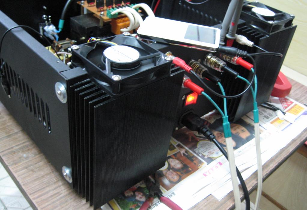

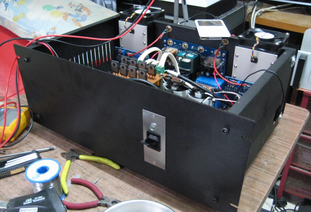

Some Pic of my FFive:D
Now just fine tuning the sound,
sweet point 0.6V with no doubt:rolleyes:
gate stopper set to 47ohms which I cannot hear the different to 150ohms:confused:
Thanks all, Thanks Nelson Papa:cop:
