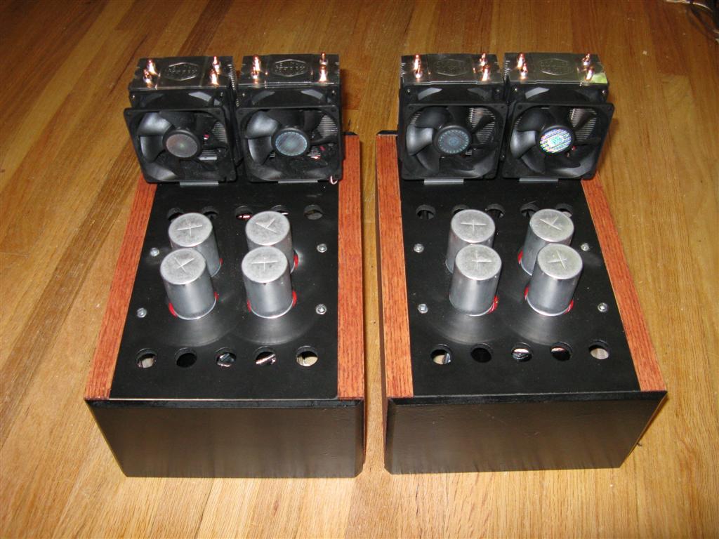

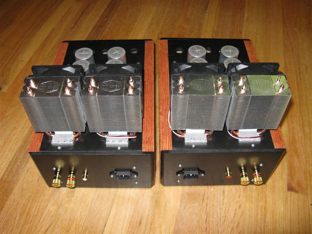

Here it is. I knew it was going to be very special amp, so I decided to make it look different.
I went with heat pipes, as the least expensive finned aluminum heat sinks would cost me around $120. Those were $14 each delivered. Saved some $$$, but took way more time to build. Because of limited chassis size, caps were mounted on the outside. Reminds me of a tube amp. :D
Voltage regulator circuit had to be added, so fans can get 5V-12V range from 48V. I may swap it for temperature controller circuit in the future.
Each channel has 300VA Antec 2x18, 4 x 47'000uF caps, bride rectifiers are on internal heat sinks, and they do get warm. I have drilled some holes in top and bottom surfaces to allow for natural air convection. I may add another small quiet fan on the back surface to lower the internal temperature.
The heat pipe approach works great. Each can dissipate 90W with fan at full speed, so it can dissipate less with fan at lower speed. eBay has plenty of heat pipe sinks from older hot P4s that would work great for class A output devices, with some modifications of course...
Still need to add fuses ;)
Once again, thank you for sharing the design Mr. Pass.

Michal, Congratulations on a successful project!
Could you describe a bit more about how the heat pipes were attached, mounted etc. I am not familiar with these and a description/photos would be much appreciated. I have used fans in the past and they can solve a number of problems. Your build is so compact and attractive.

Have considered the heatpipes many times but am always at the electronics store looking at them and wondering 'well, how much heat do they dissipate?" The manufacturers dont often post dissipation on the packaging of the heatpipe heatsinks.

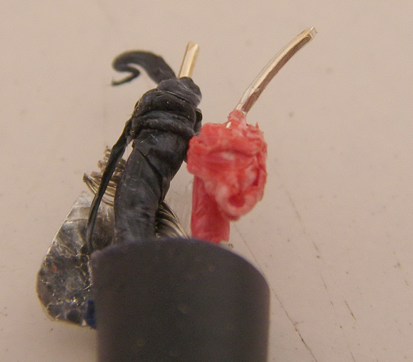

I use 30awg silver wire and then put teflon tube on it. One ground one signal. Switchcraft RCAs. Nice sound.

Thanks for the positive feedback ;)
Heat pipes are now very popular in computer processor cooling, and CPUs usually dissipate > 60W when fully loaded. CPU coolers also have to work inside the computer case, thus with higher ambient temperature. So such cooler will have excellent performance handling lower dissipation, at lower ambient temperature with lower fan speed.
After I saw one fellow diy'er using them as well, and chatting with bear and gmilitano I decided to go for it.
I got mine at ncix.com, price matched trough shopbot.ca. They are Coolermaster Hyper 101I Direct Contact 2 Heatpipe CPU Heatsink for socket LGA1156 and LGA775 with 80MM Bearing Fan.
One can use even quieter fan, look for heat sink and fan recommendations at silentpcreview.com, but then costs go up.
Mounting was time consuming. I had to drill bigger holes, get some aluminum bar to attach the transistor to the heat sink, as well as attach the heat sink to the chassis, and then PCB to the transistors. I'm in a process of making up a page explaining the construction.

- try tiny solid core for input signal wires - 0,1mm dia , twisted .

38 gauge wire!
I've tried as low as 32 gauge but found the sweet spot (in the equipment I was using at the time) to be between 24 and 28. For speaker wire I'm currently using 20g. But hey, with 38g wire even gold would be affordable :)

I vote against any fans, but i have a very quiet environment... transformer buzz, if it happens can be annoying.
If I was going to attempt a fan, I'd recommend a pressurized chassis/chamber using a centrifugal blower, oversized and running slow to keep the HF noise quiet... the pressurized chamber/chassis is to provide "inside" airflow that then passes through the fins to the outside... this will minimize the noise if done well, but not the size...depending on the choice and method of mounting the blower...
I am curious, how hot do the fins on the heatpipe heatsinks get without the blower, and with - and are you using a temperature proportional control of the DC voltage to the fans??
_-_-bear
Everything fails, it's just a matter of time. Computer fans are rated for more than 20'000 hours. Harsh conditions will make fan fail much sooner: dust/grease, high temperature, high RPMs, improper mounting.
As for noise, under volted fans can be inaudible in this application.
A simple circuit can be added to monitor if fan is spinning, and if not, an alarm can be activated, or even power turned off. It complicates the design, but that's the trade of for not using large finned heat sinks.
