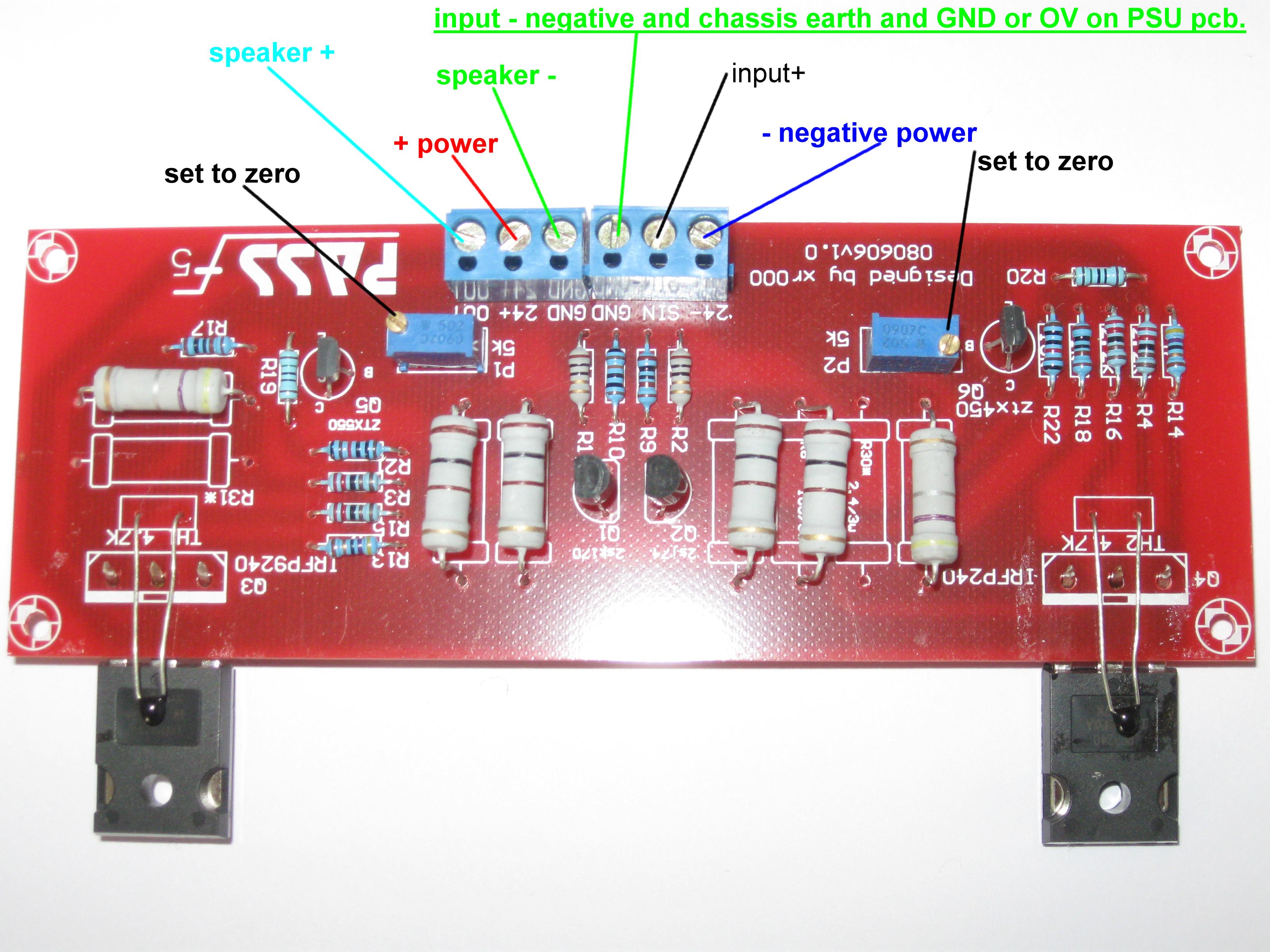

I saw one quite like it and it had errors. Check your PCB - compare it with schematic, it might be bad...
"supply" sorry
these boards work fine, (sorry guys I got that board before I came across this site) Ive uploaded a pick of what to do.
DONT CONNECT SPEAKERS UNTILL voltage adjustments are set and then
use some old or cheap speaker make certain no noise coming through.
Please, check orientation of Q1 - it looks like it is turned the wrong way around....these boards work fine, ...
When it sounds as good as this and other guys with high end gear agree, I dont care if all the component are inside out its sounds amazing.
