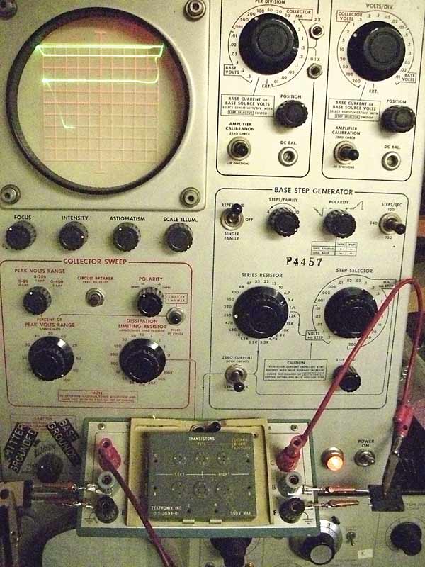

I did further measurements regarding the actual spread of the bias points for the batch of Js & Ks that I have on hand. It appears that the biggest spread is on the order of <200mvdc gate bias for the same current matching point. This is good, since the curve tracer displays minutia very well, and it looked like the spread was far far more than that. It's actually rather small in practice.
What this means is that for the double Mosfet (2 per rail) boards pairs from ends of the spread will not really be far apart at all and should work fine. Pairs for the standard one Mosfet per rail F5 will be easy.

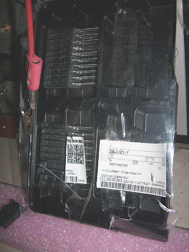

TOSHIBA MOSFETS
Awayne, out of this batch there was no possibility to find the number that you wanted. Zilch. I would need a batch of 200-400 per type to find the number you wanted...
So, post up if you want them, even if I run out (and I will, there aren't that many to begin with...) otherwise I won't want to go out and buy several hundreds of each type myself.

Are they matched at room temperature or at steady state on heat sink ?
Curve tracer matched Quad Comps are a must for those serious builders for Xed F5.
Can your curve tracer output data in digital format for post processing ?
Patrick
Room temp, which is cool.
The device does not heat much during test, unlike a static bias test jig.
I could let them cook for a while (actually I did... on a few to look at the change) but my experience with the Hitachi's is that there isn't a whole lot of difference in the spread when tested warm or cool. The pix from Luvdunhil's posts when he was selling them shows the same thing... fwiw. No worries, mate! ;D
this is an older Tek 575, no digital anything. Toobes to test tranzeesterz!!
Yes, for the X5 or the CViller boards having the devices on each rail very close is important...
_-_-bear
