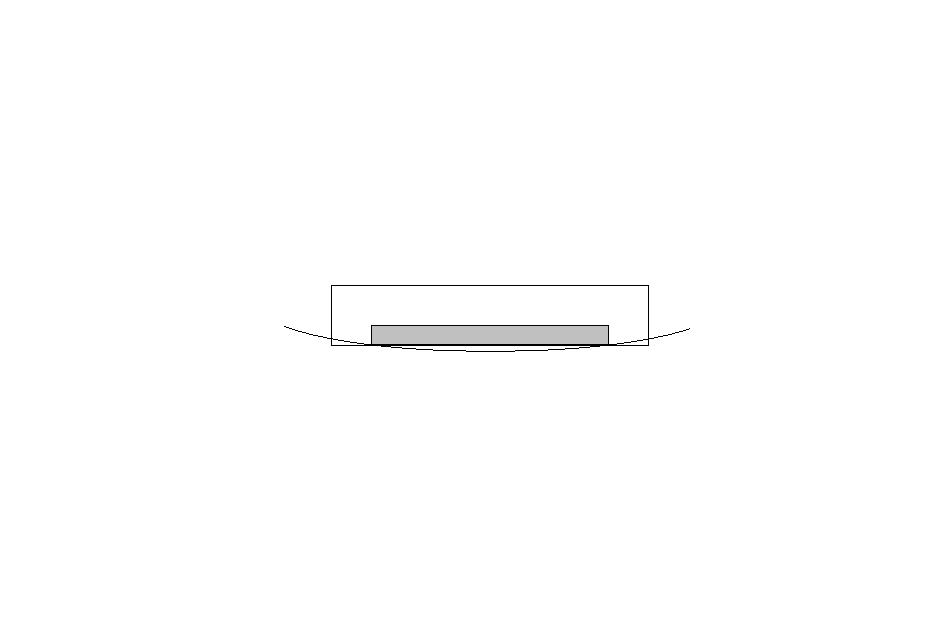

Well, the real bad thing about non plane heatsinks are that just the slightest whatsoever small non linearity results in the device standing on its edges only
Its not uncommon that heatsinks are curved like in drawing
Basicly happens because of the fins
And you can try and sand it from now until end of days, it wont help
Apart from machining, maybe the best one can do is to just carefully sand away the plastic edges on device, as a smaller device means smaller problem
But first determine how much of a problem there actually is
Place something small and plane on the heatsink
With a small penlight you will see how much it really is
Tinitus, we have a minor disagreement on your point...
If one uses a dead flat backing and successively finer grit one will get a flat area as a result. Referring to your drawing, you show the black object making contact on just the edges, this is precisely what will happen if you use a dead flat backing while abrading the surface, the edge will cut first, then finally you will get contact to the center...
Using "machinists blue" you can determine your contact area. A permanent marking pen is a good enough second best for this test. The areas not being touched by the abrasive or flatedge will remain colored.
Reducing the size of the device is not a good idea in general.
I do agree that if you take a known flat (of appropriate dimension) and lay it on the surface, a bright light from the other side will reveal many issues.
It will not reveal a surface that is flat overall but that has a groove ^^^^^ pattern from something like a mill or flycutter. That too will create a reduction in contact surface area.
_-_-bear
_-_-bear

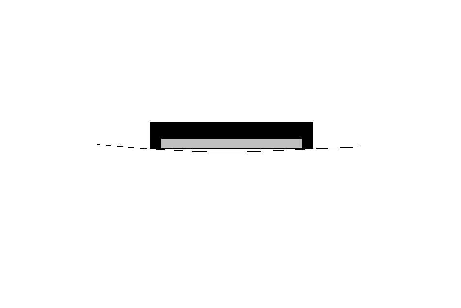

I never suggested that
Its not about reducing size
Its about doing what "resembles" that of a smaller sized device, less play
Its about "forming" the back of device, by sanding the edges only
This is similar to reduced width resulting in less play, thus better heat transfer
Its close to what was previously suggested with sanding the back of device
And mostly what would happen doing it that way
I have tried sanding a black heatsink, and Im not doing it again
My new heatsink is raw alu finish, and perfectly plane
My other black ones are not

Tinitus,
I see what you are saying but I don't think it really works.
If there is sufficient curvature to keep the center part from transferring heat as in the first drawing, and you modify it to look like the second drawing I think that you will only have edge contact, and the center area will be a very hot spot.
Better to use a silpad since they are designed to suck up some difference?
I've had not difficulty with black or any other color anodized heatsinks when it comes to machining or "sanding"... if ur new heatsinks are un anodized then the top surface will be soft (but you said it is flat anyhow). Anodize is hard. What they call "hard anodize" is, well, harder!
It works
I didnt say it would be perfect
But still better than doing nothing
Play will be less, and pads/grease more effective
But there is a better and more professional way
And it doesnt need advanced tools
You need a stationary drill machine, and an endmillling cutter
With the endmilling cutter you should be able "spot mill" around where the output device is supposed to be
I havent tried it yet
