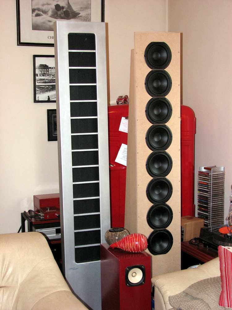

What would you recommend in a slightly different arrangement? Say, ESL of some 88dB and a line array with 8x 6.5" bass-mids pch which will add up to some 98-100dB sensitivity... I am about to finish my set of two dual mono F5s but am not really sure that this will be the best arrangement. I also have just a few days to play to finish Aleph5 (the only problem is to find that time) but in this case, if the F5 can't really push the ES panels as it should, would you suggest using Aleph for that job? The plan is to make the crossover somewhere around 200-350Hz max... And this is how the speakers look like... (the small FR fostex is not part of the system I am talking about)
stein2 said:
I agree with you on this...
I woud think you need more than an F5 for the ESL so it will play loud enough.
