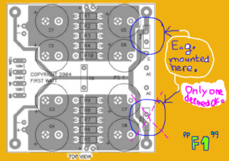

sandbasser said:I'm very much a newbie here... but I decided to join the fun and build an F5. I've ordered boards and I'm acquiring parts now...
I've been closely examining the doc provided in the 'F5-om_sm-080527.pdf' file. On the last page there's a schematic for a Power Supply. My question is I don't understand the function of the thermistor in the lower right hand side of the schematic... (it apparently connects 'output' ground with chassis ground) I'm not too sure of what to use and where to mount it... I thought thermistor had to be near some source of heat to protect. So, what is the thermistor for; and where should it be mounted???
Any assistance would be appreciated.

I think the thermistor was to help prevent a ground loop.

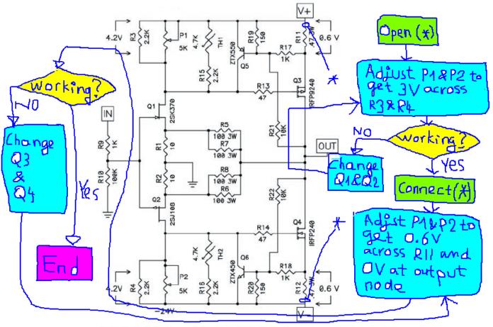

I can't seem to get the bias set across P1 & P2 so that i don't see serious dc voltage on the speaker binding posts-= we are talking 20- 24volts here- I have two multimeters reading dc across P1 & P2 and at certain points they track nicely- but I can't drive the dc at the binding down- I've spent much time turning those leetdle brass screws back and forth and back and forth( such a headache I've got)

have you checked if the output stage mosfets are still operational ?
or re-checked after you put them back in ?
i have blown a few of IRFP240/9240 on the test bench and sometimes you can get low resistance from gate to drain or drain to source which is easy to check for.
this is probably the last thing you want to hear right now but if you simply de-solder the mosfet and do a basic DMM check of the mosfet
make sure its not low ohms between pins this can save you alot of additional headaches.
OR with the amp on (carefully dont slip and short the pins together)
make sure the mosfet is not acting like a switch, if it is it will have a very low voltage drop across drain and source pins.
(yes i know this is a "rough as guts" method)
if any one disagrees or wants to chime in and add a better method here feel free to hammer burn abuse argue disagree in general etc.

sandbasser said:. . . thermistor . . . where should it be mounted???
Here, for example. ><

desolder mosfets , test them looking at procedure in first pic
www.passdiy.com/pdf/matching.pdf
read ;

Sandbasser:
The thermistor is there to help prevent ground loops by putting some resistance between circuit ground and safety earth. The idea is that there is higher resistance when no current is flowing to earth (ie the way it should be) but then if something should happen to cause the current to flow (ie short from circuit to chassis) then the thermistor quickly warms up, the resistance drops and the fuse blows/breaker trips.
Another way is to wire in a 5 or 7W 10-20R resistor in parallel with a 0.1nF cap and 2 diodes wired back to back. All components rated highly enough to stand the current and voltages involved (works well but not the officicl "pass" way of doing it). The thermistor works great.

Re: f5 not blowing fuses but....
If sure that all FET pins are correctly connected and Q3/Q4 are
electrically well insulated from the heatsink, I would try this too.
Good Luck . . . ><

BABO ..... you're my .....
BASIC Master ........
Babowana said:
Good Luck . . . ><
Re: BABO ..... you're my .....
That's the best decision tree I've seen in a while!
Good Luck . . . ><
