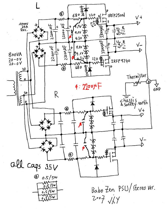

Oh ok. So like 20VAC? Because you adjust it down to the correct voltage? What voltage do you need with the ZV5 PSU?
For your info, attached is mine as built for the supply rails of
about +/-20V.

Dougie085 said:
The ZV5 will work with the 20VAC and everything won't it?
Is your PSU regulated? Also any particular reason you used 4 22,000uF and then 2 33,000uF?
20VAC works fine with me. You could increase to 22VAC.
Still you could use 35V-rate caps.

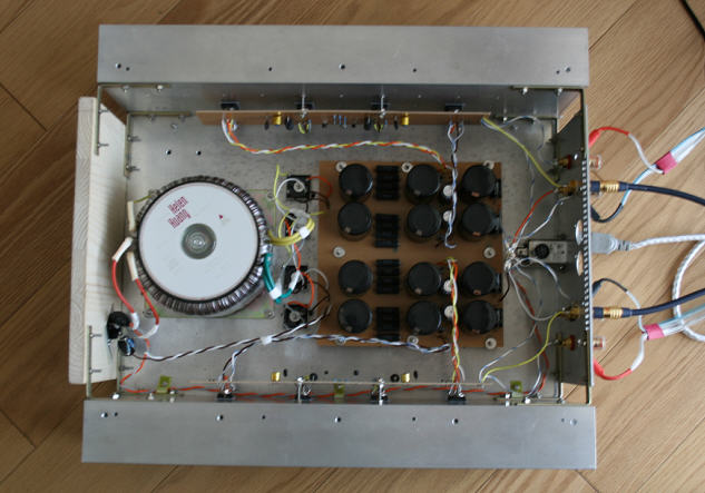

From the picture, you can see four MOSFETs/ch. Two are for
the regulators, and another two are gain MOSFETs.
No particular reason. I'm just a poor man...
You could use 33,000/35V for all...
