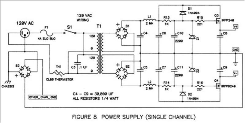

Well thats for one channel and doesn't include the switch, transformer, fuse and stuff. Do you think you could make up a BOM of yours? I used this schematic.
I tired but I'm not the greatest at reading schematics And like I said I wasn't sure what values the zeeners should be and what not and what the rectifiers should be.
Dougie085 said:I shot him an email. See what he has. It's ok to use caps larger the 30k uf in this PSU right?

Dougie085 said:Yeah I looked he didn't have anything listed that would work.
http://tiny.pl/ngd2
look for 12,000Mfd/50V ; 15,000Mfd/63V
if that isn't a deal , I dunno what is ......
Dougie085 said:MFD isn't the same as uF is it?
yup ,it is - most the time ;

Dougie,
Maybe you should consider an unregulated PS. The
ZV5 needs one but the F5 doesn't. ("Ordinary
unregulated supplies will work fine....") This will
simplify things quite a bit.
The caps that Zen Mod mentioned are a good deal
and definitely worth considering.
Also, what transformers are you planning to use?
Dennis

Well I have a Aleph PSU board that I got from chipamp.com. But a regulated PSU would be nice and I don't think it will be that hard to build I just need to remember all the schematic symbols. I'll probably just use something like a 300VA 18VAC transformer. Avel or Plitron depending on how much I decide to spend.
Wouldn't this F4 power supply work well?
My impression is that Nelson uses pretty much the same supplies with the F series unless there is a reason not to..
And if it's good enough for Nelson..
http://www.firstwatt.com/downloads/f4_om.pdf
There is a power supply schematic towards the end; Page 15
Mark

Dougie085 said:Well I have a Aleph PSU board that I got from chipamp.com. But a regulated PSU would be nice and I don't think it will be that hard to build I just need to remember all the schematic symbols. I'll probably just use something like a 300VA 18VAC transformer. Avel or Plitron depending on how much I decide to spend.
Hi Dougie,
Just remember that if you do go with the ZV5 regulated supply
that you will need a transformer with a higher secondary
voltage.
Good luck.
Dennis
