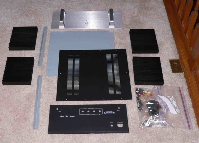

D988 Case
Yup, that is the case. Not only is it gorgeous - one of my Scotties could sleep in it. For scale, the faceplate is 19" wide !! It includes a 20A push-button switch, super heavy duty input and output jacks, IEC socket for power, nice feets and a bunch of other hdwe. It looks like one of the old Classe amp cases before they went with that crazy rounded Guggenheim-style. Shipping was another $ 120.00.
Considering the quality of this thing and all the hardware, it was a pretty good deal, especially since my wood / metal-working skills are almost as dismal as my golf swing. (I usually get to see as much of the golf course as the groundskeeper until I run out of golf balls.) The guy in Hong Kong, (Caucasian name is "Ken"), who has these things, sounded like he would support discounts for shipping quantities of 2 or more, so a group buy might be worthwhile.
