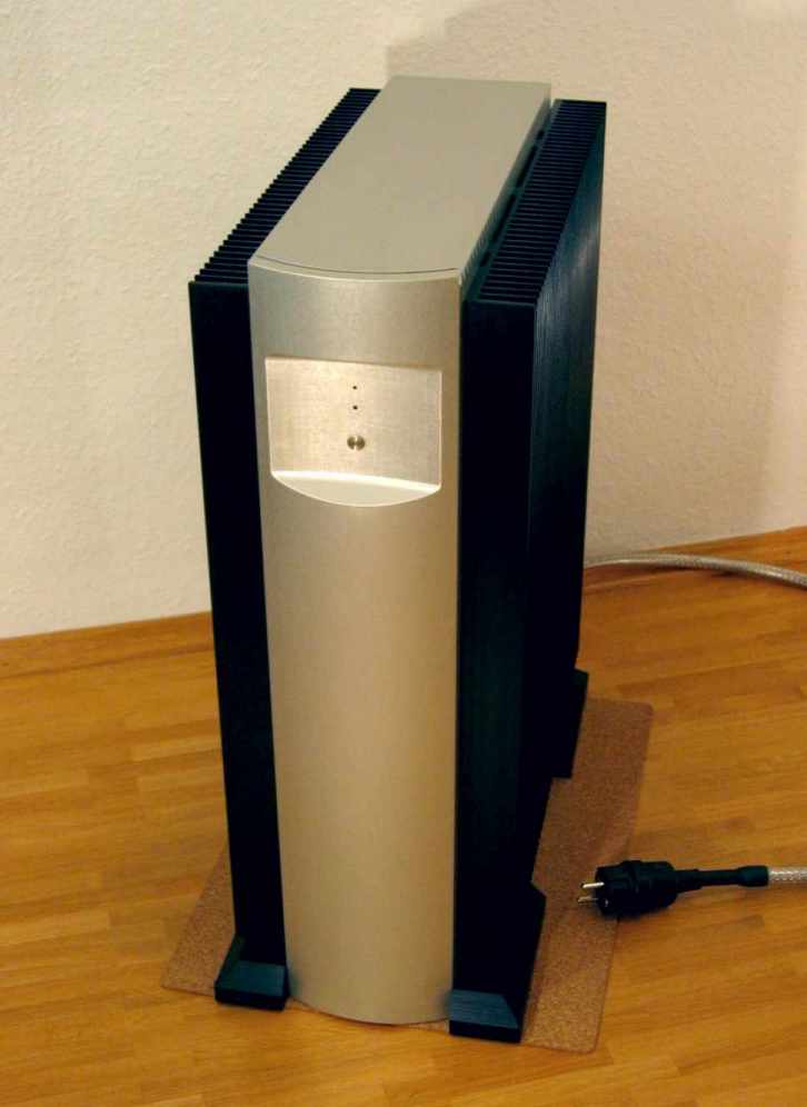

> Wow! That's a very impressive 'copy'
That is some complement coming from you !!
> How did you create the front plate? Do you have a milling machine?
Turned, then CNC milled, as the pocket is concave on all surfaces and hence more complex to make than the original ML33.
Also note no screws visible (not even at the back) and only very well placed joint lines and ventilation slots. They all made life sort of difficult.

Puts the origin to shame, doesn't it.
