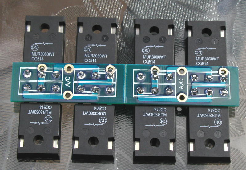

I didn't even consider using rectifiers without heatsinking, so it's hard for me to say how hot they normall run. My PS pcbs allow mounting rectifiers directly on a chassis, which I find more practical than additional heatsinks. Picture below shows one of my (temporary) test setups:
I wondered about how these boards and their output devices would mount to the heatsink. It appears your board is "floating" just mounted to the leads of the outputs? If this is sufficient, then no bother. otherwise, is the heatsink itself to hot to mount standoffs to the board? I assume it would lead to problems to mount them on standoffs from the bottom of the case and then run short leads to the devices legs? Seems they should be as short as possible? What rectifiers are those nice ones shown mounted to the chassis?
Thanks, Russellc
Mounting on leads from the outputs is sufficient. There are additional holes for standoff mounting as well, if someone wants to use wires to spread devices further way. It's been confirmed previously that even 12" wire runs shouldn't be a problem, but 220R gate resistors should be mounted directly on devices, not on the board.
The rectifiers are MUR3060

Another question, when mounted as you show, standing off the leads of the outputs, does this subject the board to component killing heat, or is this just not a problem? I assume its not, otherwise I cant imagine you doing it that way! My brain just wonders....thanks for the quick ship on the 2nd PS board.
russellc
There are no caps on a board, so heat is not an issue. Besides, it's common practice to mount the board this way, I'm not the only one doing it: http://www.marklevinson.com/image_library/33HOUTPT_lo.jpg
