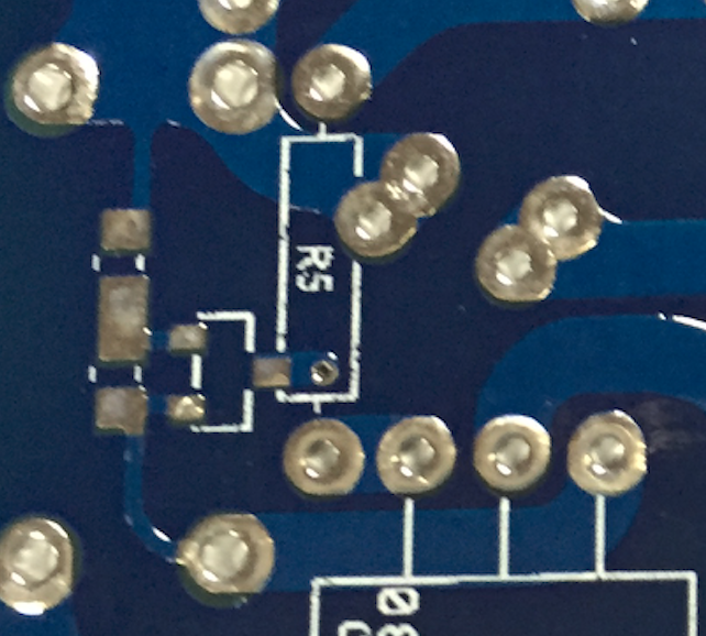

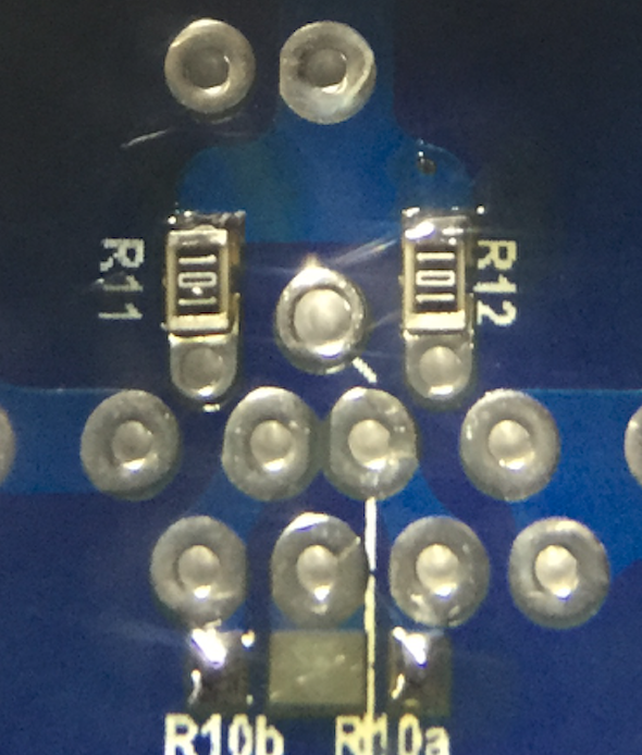

Stuff the 6 SMD resistors first (3 each channel) before proceeding with through hole components.They are found at the back of the PCB. There is actually very little components for the mainboard. Just follow the BoM and schematic and you should be fine.
One tip on soldering the 100R SMD resistors. Solder only on one side of the resistor for the first time, as shown in picture. The other side is too close to the padding for the JFET. You will likely to bridge the JFET mounting hole. You can come back to solder this side when the JEFT is soldered.
Do not solder the Jumper wire yet. It will come later.

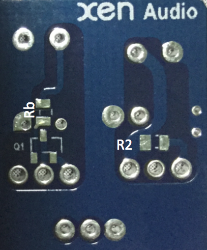

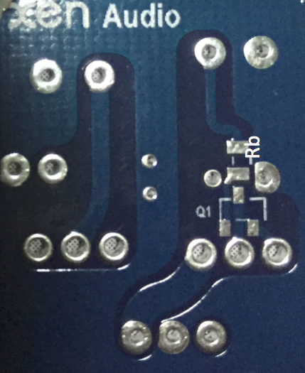

The SOT23 padding and the resistor padding at the back of the PCB is meant for the current limiting circuit. I didn't use those so it is left blank.
Note: R5 is not part of the current limiting circuit. R5 SHOULD be populated.

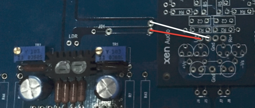

Series Resistor for LDR control goes to J21. Jumper this if you are not using LDR.

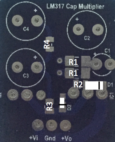

Use the following silkscreen to assist you. The diode has a cathode marking. Follow as per diagram.
This is Patrick's advice on soldering of the MSE1PJ diodes which I have used myself.
"When I did my soldering, I use a pair of sharp tweezers to grip the diode exactly at the gap.
Then place the diode on the PCB, using the tweezers as alignment indicator.
A bit fiddly, but 100% success."
Use flux to help hold the device in place and to allow solder to flow. Look up on videos for SMD soldering and practise on old boards if you need to.
After soldering the diodes, make use of the LM317/LM337(Labelled IC1) mount points to test the connection. You should get approximate 0.53V forward bias with the diode test function. When satisfactory, you should solder R2, 240R resistor next, as it is positioned beside the diodes.

There is a quite a number of jumpers on the board. 2 are absolute necessary and it is required to be soldered on before we can test the mainboard. Once the mainboard is tested ok, we can proceed for the rest of jumpers.
The two crucial jumpers connects the output ground to circuit ground and can be found at the back of the board. I made use of enamel coated copper wire to prevent possible shorts. One note on the jumper, the wire should protrude out at least 5mm in the place where I circled. This is the Out ground and it goes to your headphone jake. Pls be mindful of this. If not you will not be happy. You have been warned :D
Once you have mounted the 2 crucial jumpers, checked all soldering joints are free of shorts and the MOSFET soldered and mounted on heatsinks, you can do the initial test and biasing.

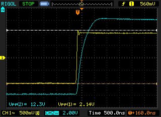

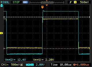

Once you are happy with the offset, you may proceed to test the board with a oscilloscope. Start off 2V pk to pk 1kHz square wave at input. Output without load will be 12V pk-pk with no ringing/over shoot. Increase MOSFET gate stoppers R5/R6 should cure the ringing. Once the waveform is clean, you may wish to check again with a dummy load.
Note the attached waveforms on my build. Yellow is input, cyan output. The slight ringing is due to my cheap DDS signal generator.

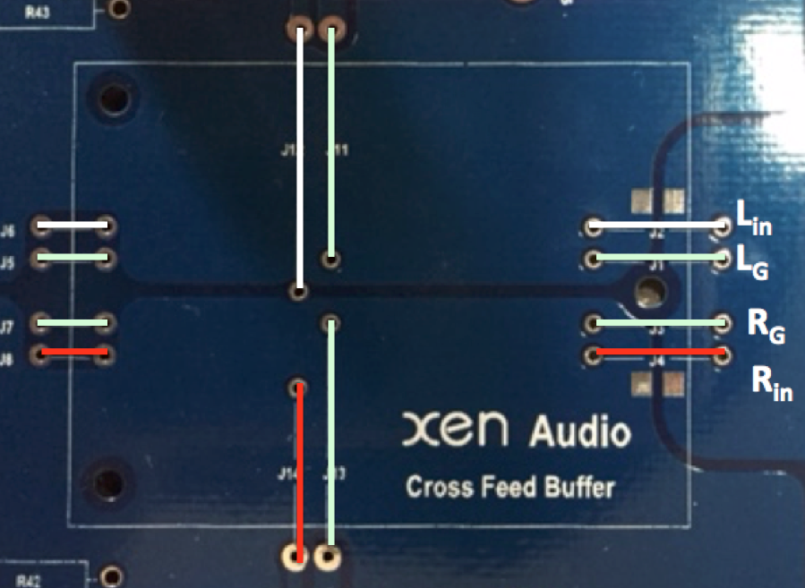

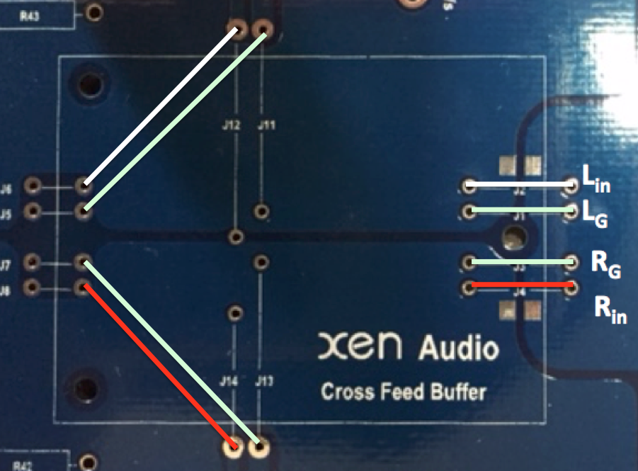

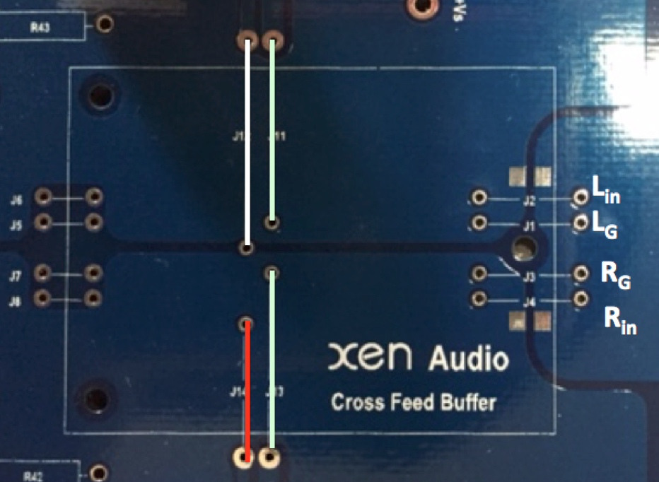

Follow the attached diagrams based on your configuration.
If you are using LDR volume control, the series resistor should be soldered in J21. If not using LDR volume control, jumper J21.
Note: If you are using LDR volume control, but not the crossfeed, you should increase the serial resistor to 10K to compensate for the gain. Crossfeed will reduce the input signal by a factor of 3 and hence if you did not use crossfeed, the proposed 5k series resistor will be too low.
The last 2 jumpers are found on the padding beside J1 and J4. These are the additional signal shielding and should be connected based on the following configurations. The padding is for 1206 resistors.
When using crossfeed, use a 0R resistor for right channel Gnd Plane bridging resistors, left channel open.
When not using crossfeed,
3-wire output, use 0R resistor for right channel Gnd Plane bridging resistors, left channel open
4-wire output, use 0R resistor for right channel Gnd Plane bridging resistors, left channel use a 10R resistor

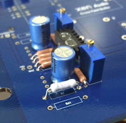

The crossfeed module I am using is the modified Danyuk board.
In addition to the crossfeed module, you will need a +-8 V power supply built on perf board. I use a simple 78L08/79L08 power supply.
Stuff the PCB with components of your choice according to the BoM.
For crossfeed to work, they will need a common input ground. Thus both input ground goes to Gnd, L+ goes to Lin and R+ goes to Rin.

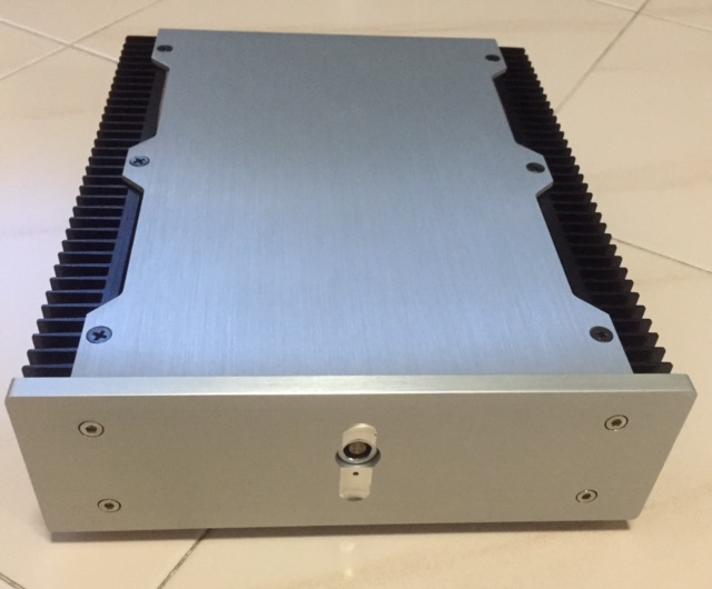

Once everything tests proper, its time to mount the transformers on PCB, power supply modules onto the chassis heatsink and then it is time for music :)

The completed Amp. Those black boxes in the middle are Vishay Metal Foil resistors for the crossfeed.

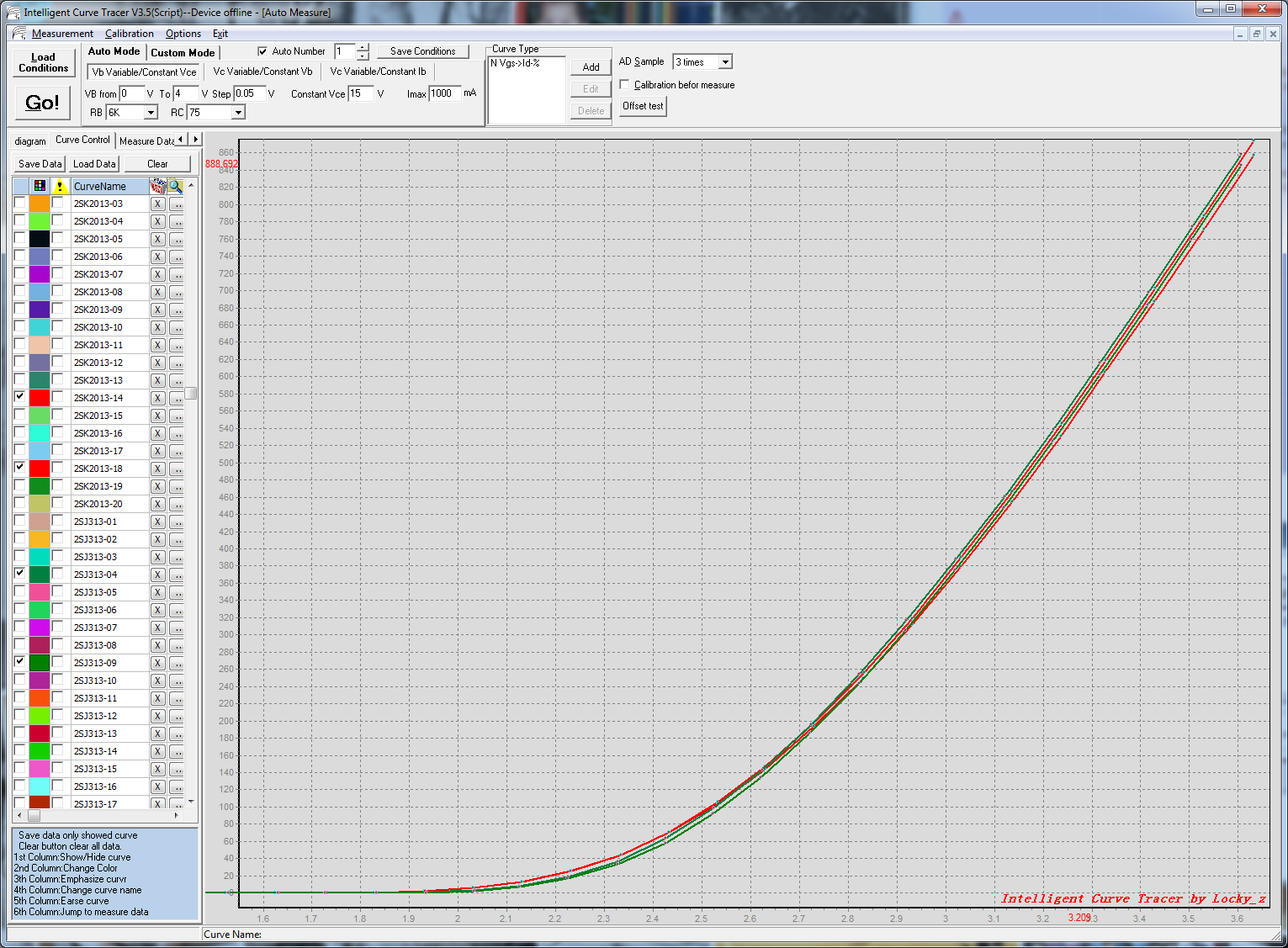

We curve traced a set of MOSFETs measured by Cloud85 with his very simplified method.
Our standard method traces all the way to 1A, which is of course far beyond the operating region of the F5-HA.
You can see that :
1) the method is still very effective in finding matched devices;
2) the difficulty in getting perfectly complementary devices.
The only solution to perfect even-harmonics cancellation is a F5X-HA.P
And even then, it is only meaningful if your source is balanced, and your headphone has 4 separate wires.
Patrick

I'll use 2SK2013/2SJ313 for my build, and selected these 2 pairs :D (the curves were just taken at room temperature, but hopefully the MOSFETs won't get too hot with 150mA bias).
And some forum members are still offering NNPP matched set of these Toshibas :).
Very well matched MOSFETs.
You MIGHT need to adjust your gate stopper values for perfect square wave.
And you also need to match the JFETs for both Id & Yfs for perfect cancellation.
That means if you are using 2SK170/2SJ74, you need to use the 5.1R degen as described in the F5X Power Amp.
Or use a true complementary JFET pair (also published there before).
Patrick
