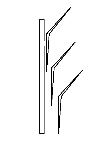

Today i went to a local store that works with metals and had a idea. If i make them cut from a 4mm thick sheet the base plate for heat sink with 400mmx300mm, then i can have smaller sheets cut and soldered to make a heat sink like the commercial F5 has. A matter of put a layer after layer with angles so that the final result is as good as other options.
And price is arround 30€ each or less.
What do you guys think?

To be honest i am not too worried about HS size.
I will have, at least, 1 fan blowing into the case.
I have to compromise because funds are too low to do the "right" way. I'm not a silence freak and also the fan is dead silent even at 110v. It's BB rather than brushed.
I am going to follow the diy HS route. Seems logic and much much cheaper. I can even put thermal paste between plates and solder them completely arround junctions.
Sorry i didnt realize i should say weld. My frend has a TIG and talent
So i will weld the several plates and well see what comes out!
