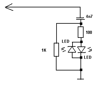

make this and try does you have any oscillation on output :

Input shorted or not, same result; off-set going back and forth, with a range of about 60mA. I don't know anything about oscillation in amps, but the word describes to me exactly what I'm seeing.
A couple of resistors, LEDs and a cap. Ok, I guess I can buy those & solder them together per shown. What should I do with it?

you mean 60mV ?
connect across output , whatever orientation ;
if you see Led's lit up , there is oscillation
you mean 60mV ?
Yes, of course, 60mV. :D
Output and ground, i.e. "red and black" spkr terminals? Can do. Once I get the parts.
Well... What if there is oscillation? Some "standard mistakes" I should look into?

there was no any oscillation before I threw in the new jfets: bias was just out of range, but stabile.

You might have just answered part of your problem,you replaced jFet and problem showed up ,a couple of possible things ,maybe that fet is bad,try another one, or the bias resistor is bad or a wrong value,some times you have to add a resistor inline with the pot to get it to into bias area ,And you say one board works fine,You've got a pattern right there ,simply measure the voltages across the resistors and compare them to the board giving you problems,The power supply is a key if it's not stable nothing will be stable so check your voltages there first,That's a good thing about stereo you got 2 channels so you can compare them to one another when things aren't right,Good Luck!!!!!!!!
