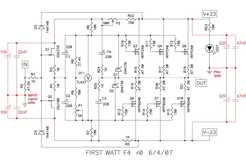

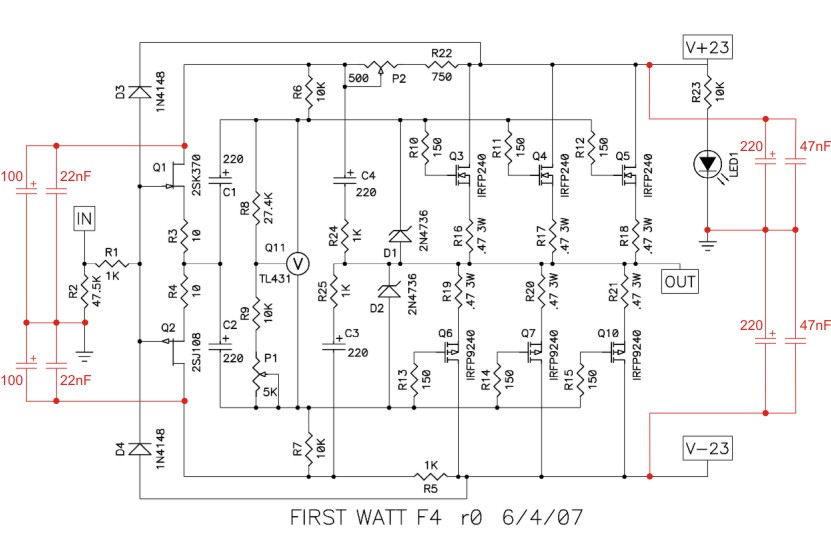

apassgear said:
Farads are good up to a point, depending on the amp bias ....I do bypass the amps PSU with some oiled polyprops cans on the 40 to 80 uf ...I also use these caps for lineamps some 25uf bypassed also with small film caps (0.1uf) with outstanding results. .......I suggest you try them and have your ears be the judge. :)
I add few capacitors to my f4 lineamps, see attached schematics. Capacitors at input are soldered directly to the jfet legs and input ground. 220uF capacitors at output are C5 and C6 on Peter Daniel board, according to his suggestion.
Overall results are very nice for my ears. javascript:smilie(';)')
wink
Best Regards,
a.

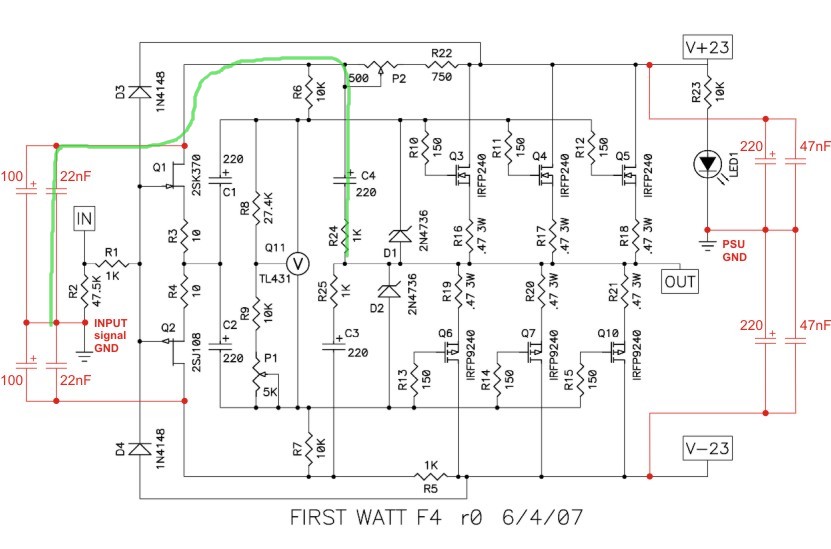

Sorry for asking, but what is the reason for providing an ac path from out to signal in gnd? If you want to make global feedback wouldn't it be more obvious to apply it to the signal and not gnd?
cviller said:
what is the reason for providing an ac path from out to signal in gnd? ....
capacitors at output are not on the signal in gnd - Peter Daniel made on his amp board separate gnd point for C5 and C6 to be wired to PSU gnd...so there is no feedback loop.
a.
