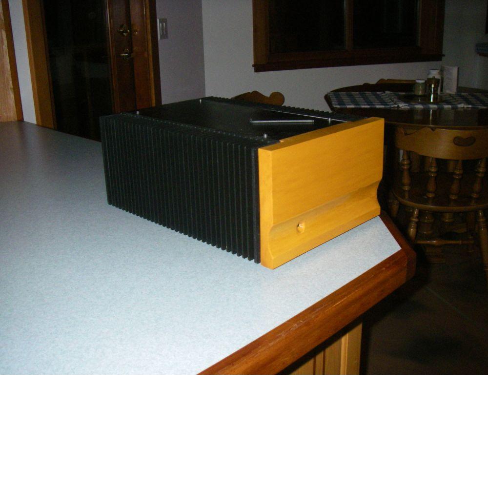

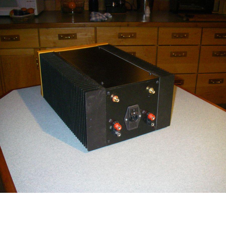

Hello folks:
I would like to thank Nelson Pass for his design, Peter Daniels for his boards and Jason for his help.
Here are a series of pictures of the F4 I built.

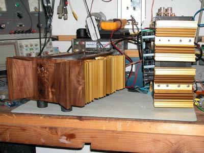

Good news from me too: yesterday my balanced f4 was born, the twin should be ready next weekend, I hope.
I would like to express my admiration for Mr. Nelson Pass project. Absolutely no problems with startup. I reach thermal stability during 25-30 minutes (50-55 C), with 250 mV bias and final excellent 0 V offset. No cracks, no bumps during power ON/OFF, cold or warm. Bias and offset adjustments are stable, every amp is like self-regulating system.
I listened it for a while, the sound is clear and nice, but at the moment this is one channel only and to quiet, driven directly from DAC by typical balanced line-level signal. As I suspected I must think about pre-amplifier, I decide to use ZenMod hand-made schematic (Post #1641), I will appreciate very much any suggestions regarding Power Supply (+60/-20V, DC).
I would like to share one of my adventures especially with novices. I start all four amps one by one separately, carefully checking voltages, bias, offset, heatsink temperature. Then I put together two amps as one balanced (goodbye my SOZ). When I switch power ON I discovered +23V at all metal parts of housing. That was a short-circuit through insulation pad caused by a piece of metal filing. In other words one of IRFP240 was connected directly to the heatsink by a very small piece of metal. Fortunately nothing wrong happened, I replaced the pad and everything is okay now. Here is the proposal dedicated to all novices (and old-hands smart guys like me): before switching power ON check if drains of all power MosFets are electrically well isolated from heatsink.
