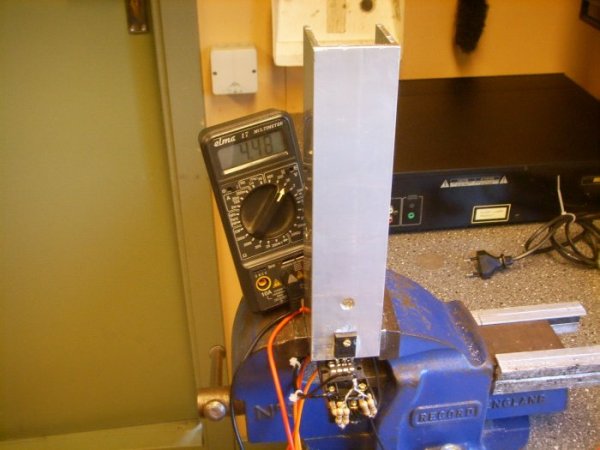

Taking from my previusly post :
I tried to make an experiment, with an 'U' shaped 230x50x50x4 Alu. profile.
The output voltage from my 5A PSU is 12.65, when loaded.
The Series resistor is 9,5Ohm which gives me 12,65v-4v / 9,5Ohm = 0,9A load for the mosfet.
The series resistor swallow 6v and gives the resistor a load of 6v / 9,5Ohm = 0,63A, which is not important in this case...
I have been making this test, with my 'U' profile 230 x 50 x 50 x 4mm.
The irfp240 have been under load for more than 1hour now.
If i deattach the profile, the mosfet get untouchable in 20-25sec.
The profile, does not get more than 30-35max C hot.
If this is the case, that i am doing this right, i see no problem cooling the F4 enough to use 24pcs. of theese 'U' profiles for making 2 monoblocks, eventually supplied with some 'real' heatsinks.
Btw: How many irfp240 / irfp9240 am i supposed to buy for matching to 4 boards ? 3matched irfp240 x 4 and 3matched irfp9240 x4 (from the same lot code i suppose)
Jesper.
Jesper.
I'm afraid I misunderstood what you were trying to do. I thought you were about to match your devices, and not testing a potential heatsink. If you run the rig in a 12V supply and burn most of the potential in the series resistor, your transistor is only dissipating ~0.63A*4V=2.52W.
I'm not sure how many output devices you need to buy, but plenty of 240 and 9240 are nice having around... ;)
CViller.
Please bare with my foolish calculating, i am trying to learn here .. :eek:
I tried to hook it up, with a 2,2ohm power resistor, and now something is really happening.
The voltage over the resistor is now 5v, and 4,97v over the mosfet.
This must give me 5 / 1,5 = 3,3A resistor dissipation.
3,3A x 4v = 13,2 watt (The 4volt over the mosfet you use to calculate with)
3,3A x 4.97v = 16,4 watt (The actual reading over the mosfet)
Tomorrow i will try it out 1hour !
Jesper.
