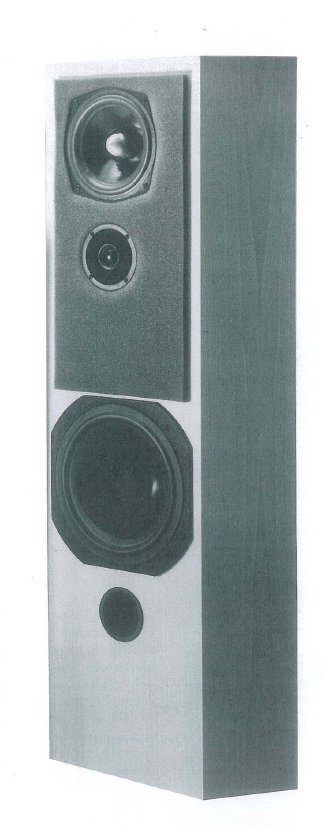

My spks are Audiovector 4 with 8 ohm's input.
There ain't much information on the net about them, but i can tell you, that my leachamp 4.5 (2x125watt/8ohm) drive them nice and loud. The reason i lent the babelfish, was to hear how much they could drive them, and that's about half way i think.
There ain't much information on the net about them....
AUDIOVECTOR 4
Freq Responce: 30Hz - 20KHz +/-2dB
Imp: 8 ohm Nominal, dips not lower than 5.5 ohm
91.5dB/1w ~ 96dB = 3.5W
Recomended Amplifier 30W - 200W
Distortion less than 1 %, 30Hz - 500Hz
Distortion less than 0.2 % 500Hz - 20KHz
Dimention: H 110 x W 46 x D 40 (cm)
All units FOCAL's modified by Audiovector of Denmark.
Actually an pretty neutral speaker.
3 way and Bi Amping/wire possible.

lykkedk,
My old Musical Fidelity A1 could play them pretty loud...and thats not an especially strong amp.
So without question, i think the F4 should be more than okay to drive them. Reason, i'm pretty sure the F4 is much more stable when driving that load than my old A1.
And then you can bridge the F4 for even more juice :angel:
