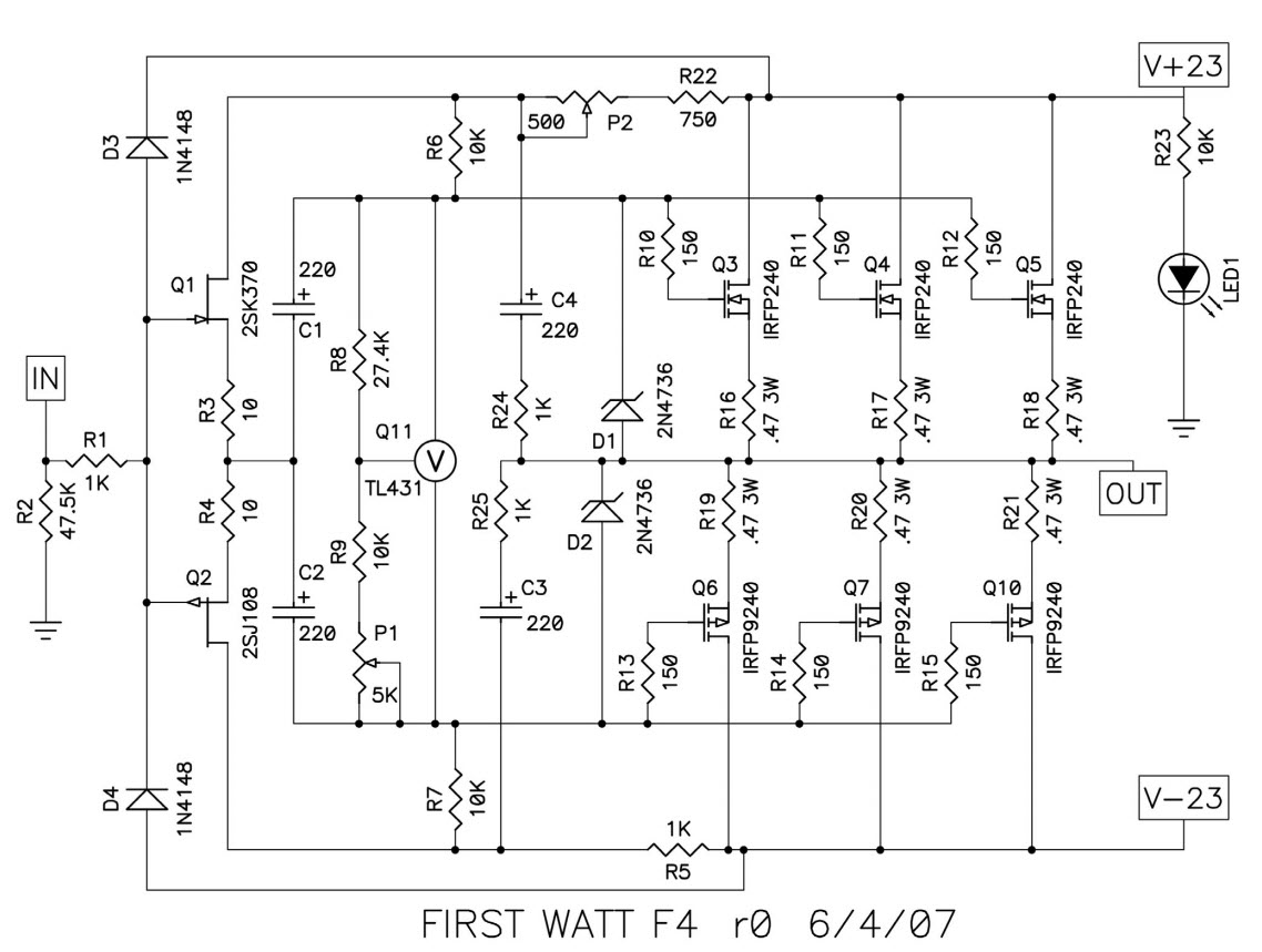

Here is my LTSpice simulation for the F4. This follows the schematic from the diyAudio Store. Please remember this is just a simulation based on imperfect models.

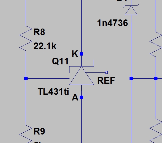

Thanks for sharing this .asc file. I had to go find a symbol which obviously is backwards. Also, when I run it, I get an error "mylib-jfet.lib" is missing"
1. Can you share your symbol file for the TL431?
2. Can you share your mylib-jfet.lib file?
You need to flip the TL431. I'm not on my computer so this is just from a faulty memory. Select the TL431 by clicking on it. Press "e" to flip it. My libraries have way too many errors to go public. Learn how to create your own in the LTSpice thread by Mooly. It's a sticky in the Software subforum.
Jim
I checked. It is Ctrl E you need to press to flip the item selected.
Thanks. I did get it flipped. That required to pull down Edit ->Move then the device can be selected. Just clicking on the placed device did not select it.

This version bootstraps the front end so that the JFETs only
see about 1/2 the voltage swing. It improves THD very slightly,
gets a tad more output swing, and it also extends the bandwidth
a bit. With a proper setup, I get about -3dB at 1 MHz, with a
very good looking 100 KHz square wave.
