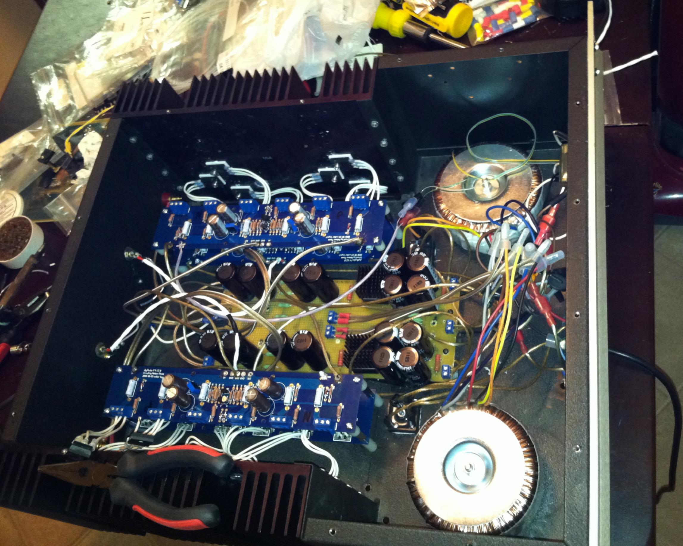

I used silicon grease from radio shack. So, it would make sense that over-tightening would cause them to short out.
Ouch. You need the mica for electrical insulation - the (extremely thin layer of) grease is there for thermal conductivity. A thick layer of grease might electrically insulate, but it will most certainly thermally insulate, and that's not good.
Hopefully you haven't zapped your fets.
I think they are good. Voltages look normal when they are away from the heat sink.
So, I could probably use the strips that were in the OM-150. I didn't because they tore some and because they are old.
Whew!
You may still be able to get TO-220 micas at Rat Shack, which can be used if you're fairly careful to position them properly, they're a bit too small for TO247s, but they will work....
Dallas is a large enough market you ought to be able to fine a genuine electronics parts store that would probably have them.

Thanks guys! I was able to salvage enough pieces of the silicon pad strips that were in the OM-150. I accidentally ordered 1/8 watt 750 ohm resistors, so I also grabbed some 680 ohm (I think) resistors from Radio Shack for R22, thinking that it might not matter too much because P2 could be able to make up the difference.
However, I am not able get the bias high enough. Should R22 make a difference there? Do I just need to lower R9?

I got some aluminum oxide ceramic thermally conductive insulators for the transistors. They are much thicker than I imagined. I can't figure out if I am supposed to use the silicon grease with them or not, so I didn't apply any.
I will be receiving some more binding posts tomorrow, and I will finish this four channel F4 amp as well. The lower level is all hooked up and biased. The upper deck was biased in the other chassis. This chassis originally had two columns of 4 TO-3 type mosfets on each side. It will now have columns of six, slightly staggered. From feeling the heatsinks with only two channels installed, my instinct says they will be adequate.
