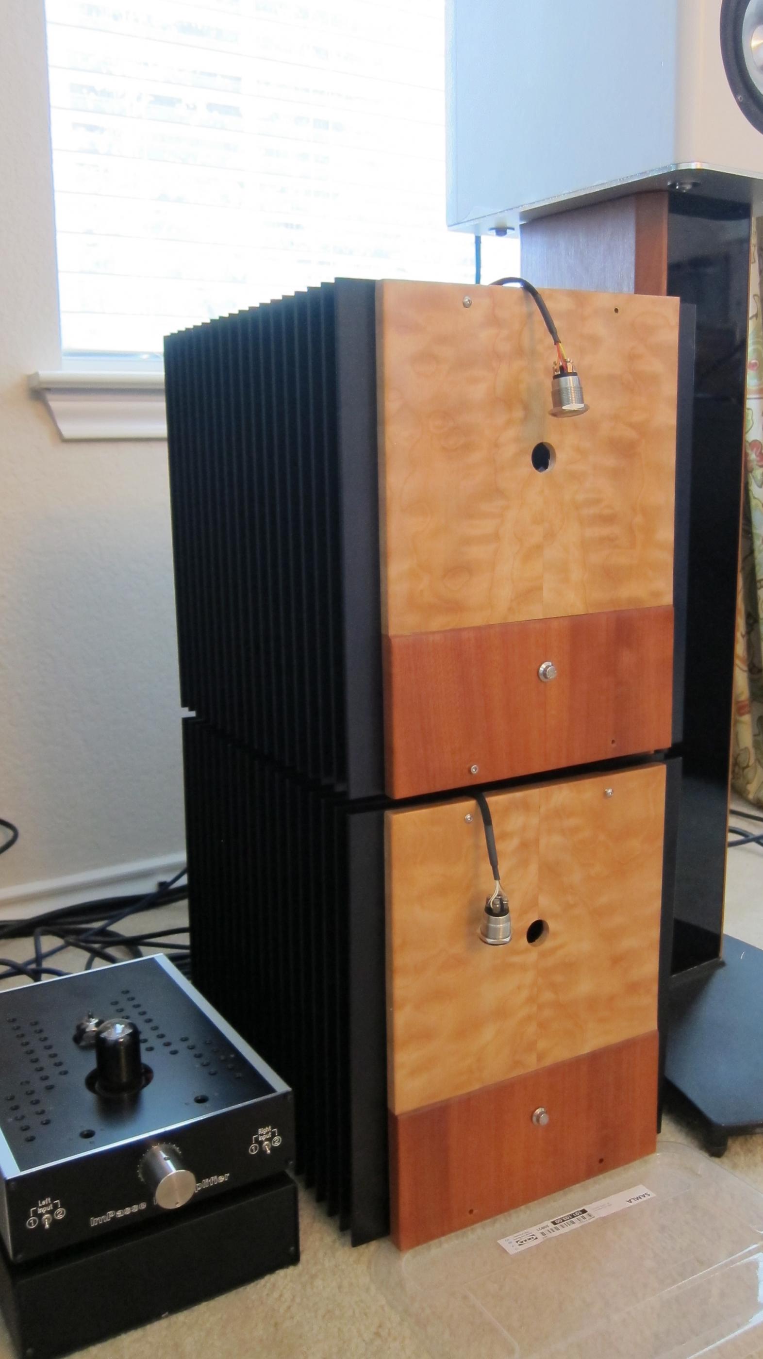

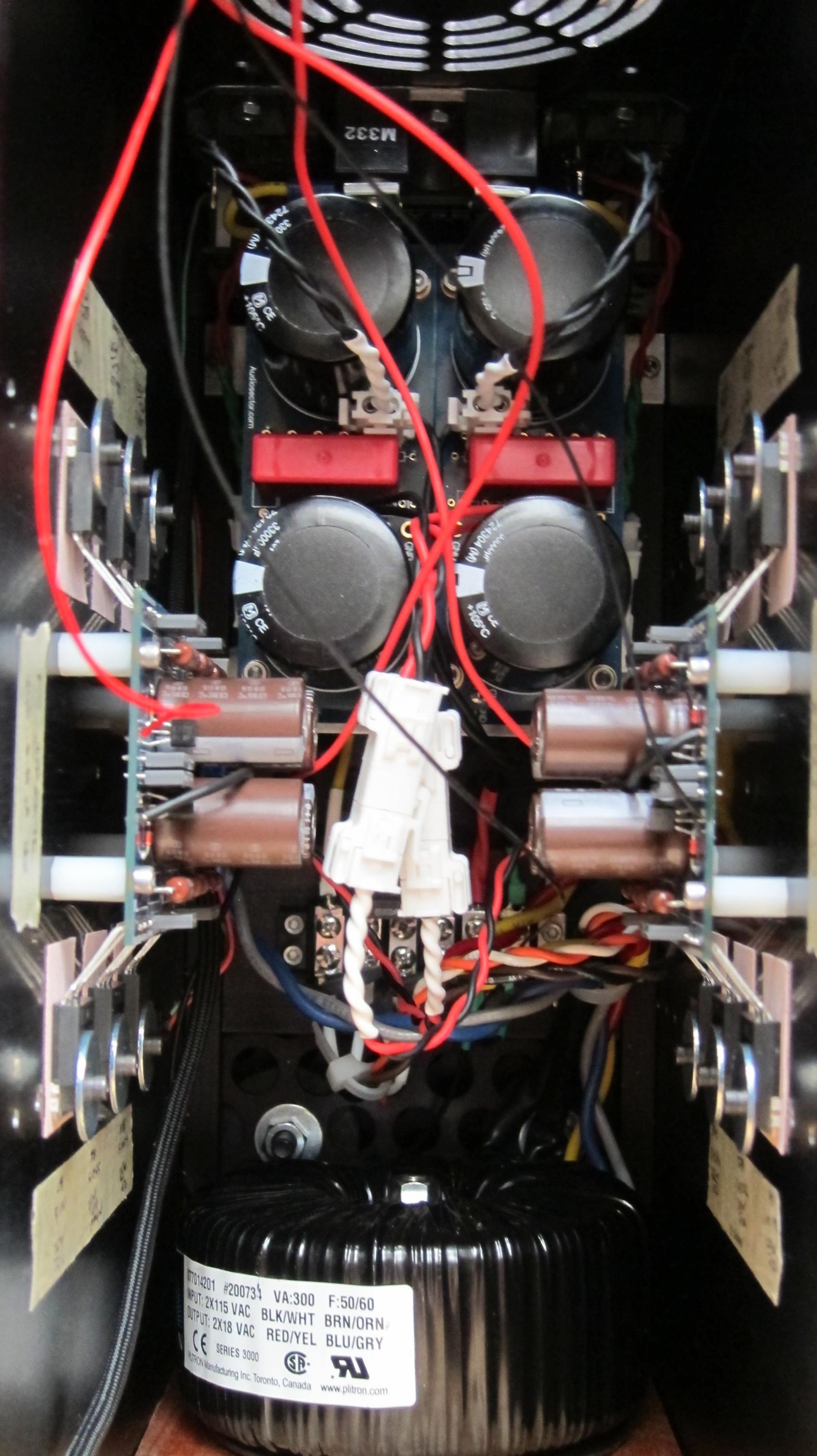

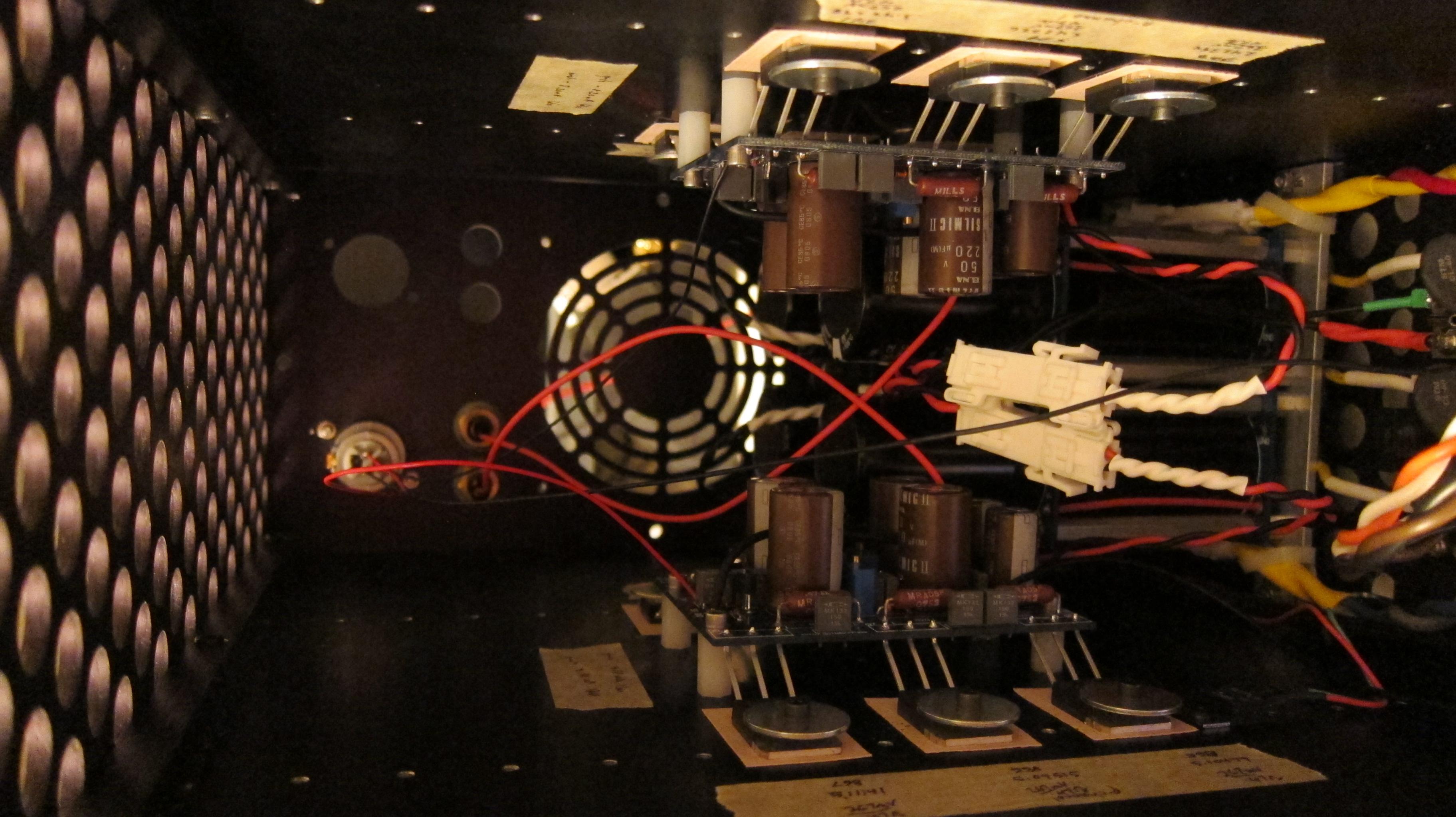

well, tolerances ganged up against me and my front panels don't quite fit. That and drilling into the exact center of the end of a piece of square rod is skill that seems to allude me. Also, I need an odd screw length to affix the bottom half of the fronts, as it seems to be between two sizes and I didn't really tap enough threads in the rod to allow too much length there. Regardless, tonite will be a good night with lots of listening :)

It doesn't look like I will be able to fit two channels per side after all. I guess I will have to scratch off the 150 and make it say "OM-25". :p

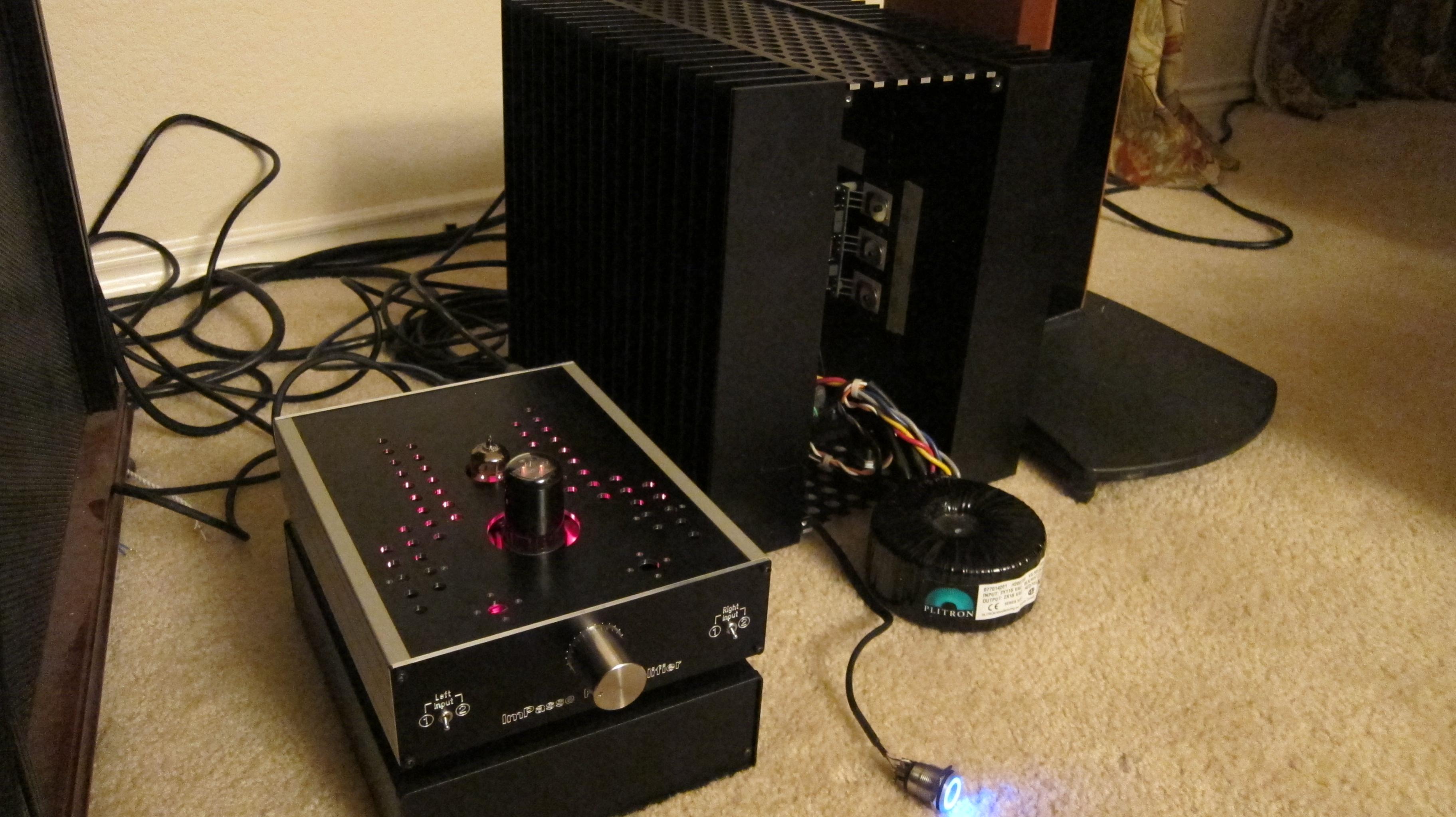

Another update on my end... I have assembled my CRC board. My power transformers (this is one of two amps I am building) are arriving tomorrow. The wife will be away for the night. If all goes well, I should be late for work on Wednesday. :p

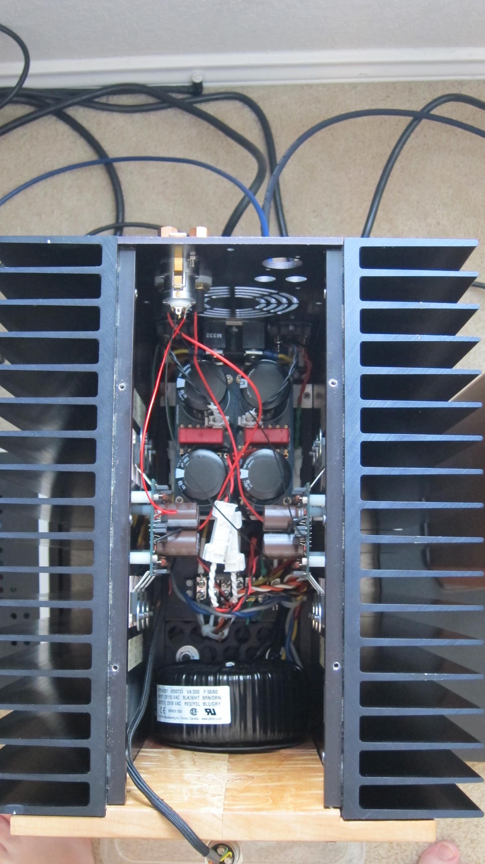

P.S. and before anyone makes fun, yes, those were the cheapest PSU caps I could find. Also, maybe someone could weigh in on whether the rectifier heatsinks look adequate. I really have no idea.

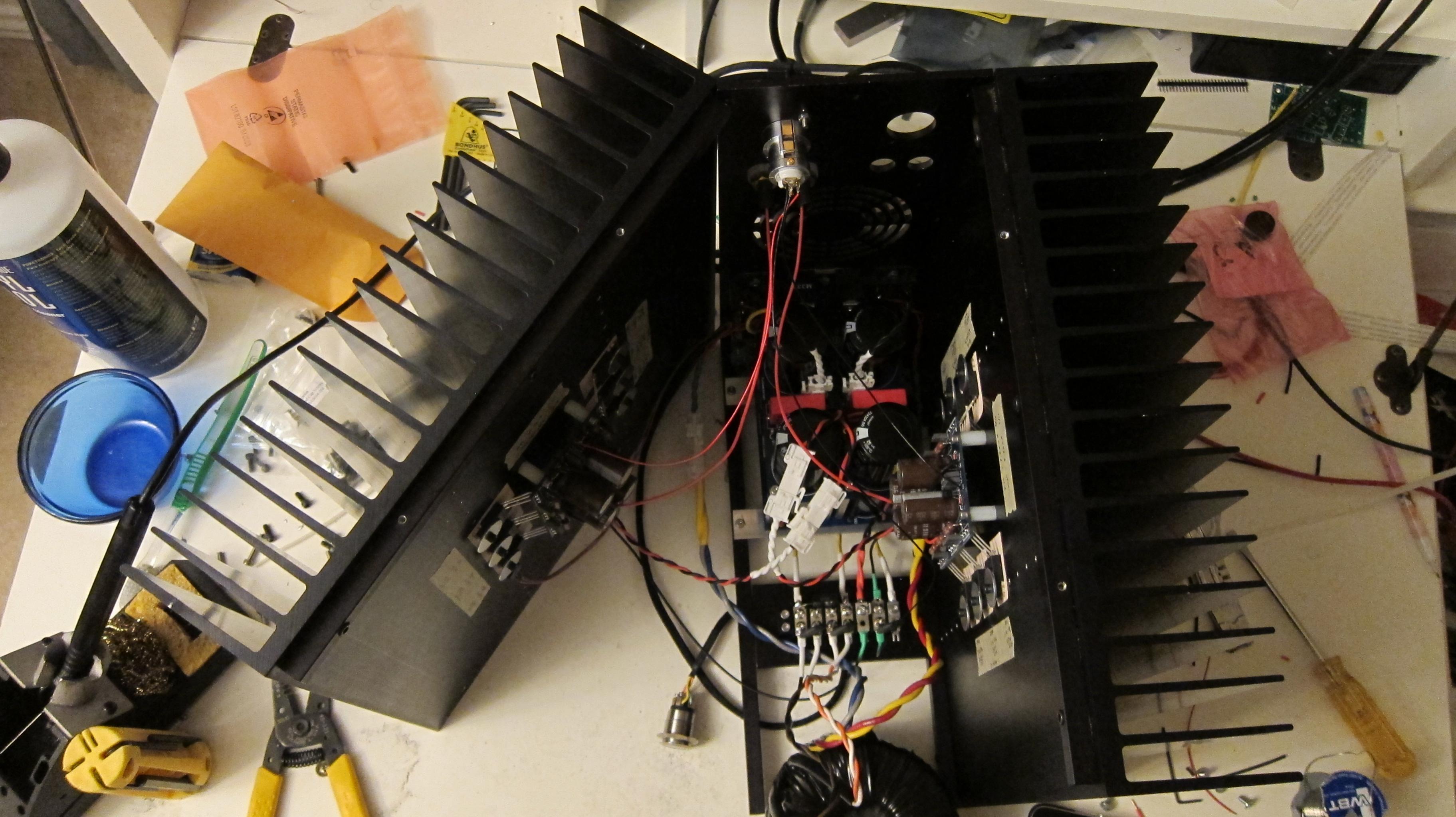

One of these channels was initially not working right, where the PSU resistors started to hum and smoke a little when powering up. Also, the led wasn't coming on. I found that it didn't do that when the bar that clamps the transistors to the heatsink was not attached. I taped up that side of the board. Now when I power it on with it clamped in there, the led comes on, but after a few seconds it shoots sparks from the heat sink to these wires that were set to the side, as in the photo. Is it possible that I damaged the transistors by clamping them too hard?
It sounds amazing. I'm getting a pretty hefty transformer buzz though. It's unclear what is acceptable, but I can make it out from my listening location if the house is quiet. I am also getting some of the same through the speaker and am not sure if it's related. It's of a different pitch, for what that is worth. I have kept the amps on for the past time and they are rock solid stable. I have some headroom for bias, but given the compactness of the build, adjusting things isn't too easy once it is screwed together. I guess that was a minor oversight. I did correct that with the F5 building I'm working on though :)

Are the transistors isolated from the sinks with mica or silicon pads ? It's not obvious on the picture...
I guess you already know that, but the case of those FET is electrically connected...
Also , i'd check for connections between the clamp and the FETs.
I would be very surprised that the transistor die would be damaged before the casing shows clear mechanical damage.
