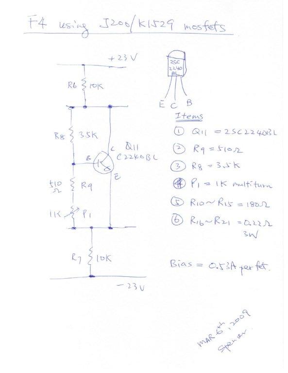

I have been using the F4 for quite some time and still very satisfied with the sound. Since I am able to find some Toshiba mosfets J200/K1529 and thus I have modified the F4 as in attached to use the Toshiba mosfets. I have reduce the source resistor to 0.245 ohm (0.51//0.47) due to good match of the mosfets. Below is the modification I did on the bias circuit.
The sonic of Toshiba mosfet is more refine to me especially on the mid and high frequencies.
