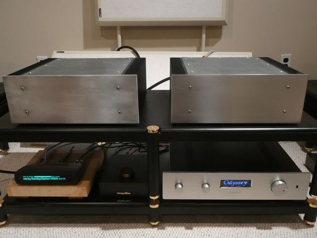

Finished F4 monoblocks (finally)
I am building a pair of SE Mono F4's and would like opinions.
I have 2 pair of the Conrad Heatsinks from the group buy.
Would mounting 3 Mosfets per heatsink and running a higher bias current to get 50 deg C be better than all 6 Mosfets on 1 heatsink at a lower current?
What bias current would each allow for.
