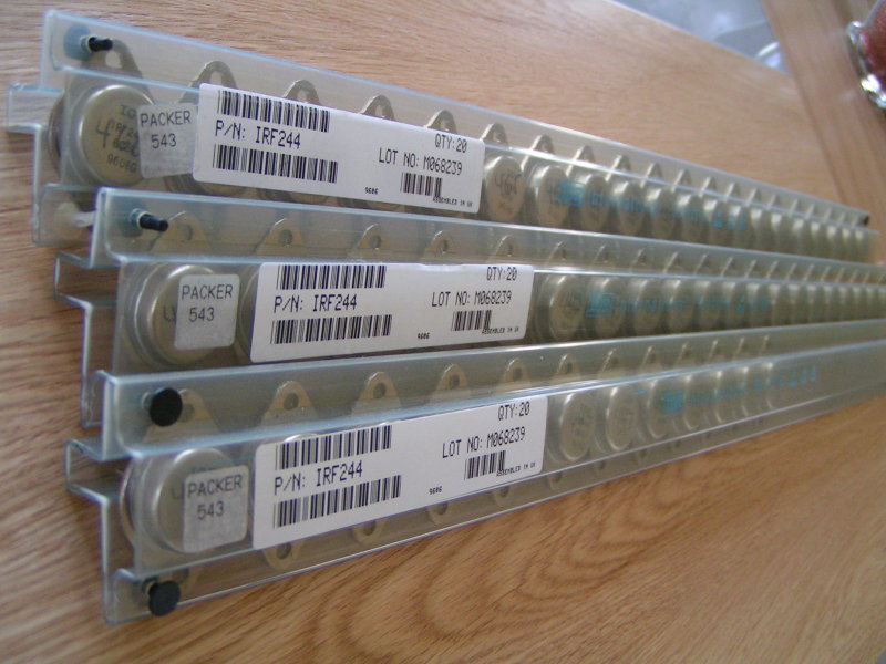

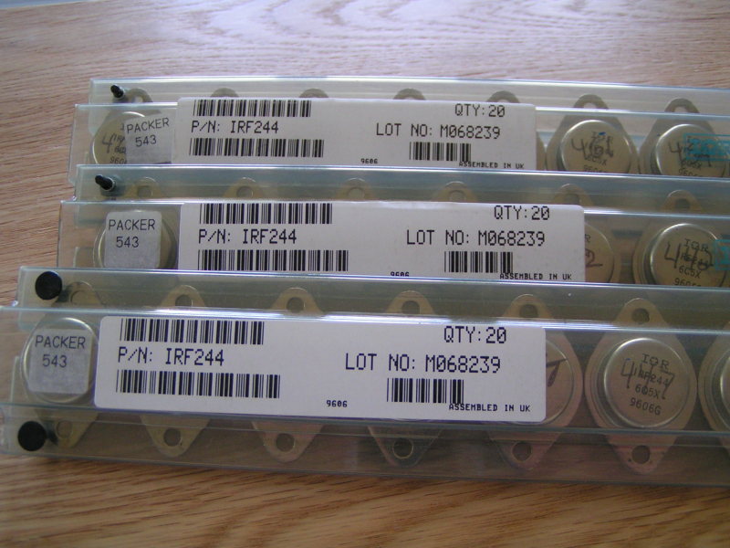

Say what, i didn't quite get the "matched" part ?
Alexi, bite him.
Well, I seem to have had a senior moment. Those are IRF244, and for the matched part, take a look at the handwriting :D

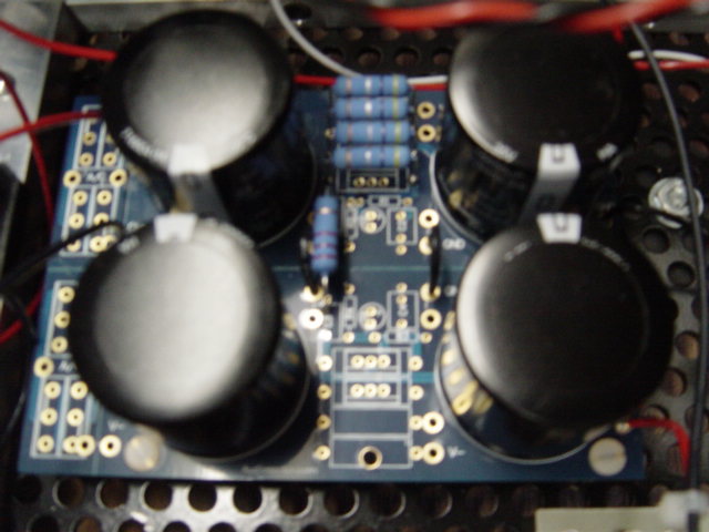

i took a heatsink off while it was on and swung it way out of the way--no difference.i'm thinking i need to look at the power supply here is a pic of the board.the 2 black jumpers tie the ground rails together and there are two jumpers underneath that go from + to + on the caps(and - to - on the negative supply with + going to the ground rails of the board) i have + and - 24 volts dc---everything measures fine voltage wise and the amp sounds maaavalous just got hummmm :(

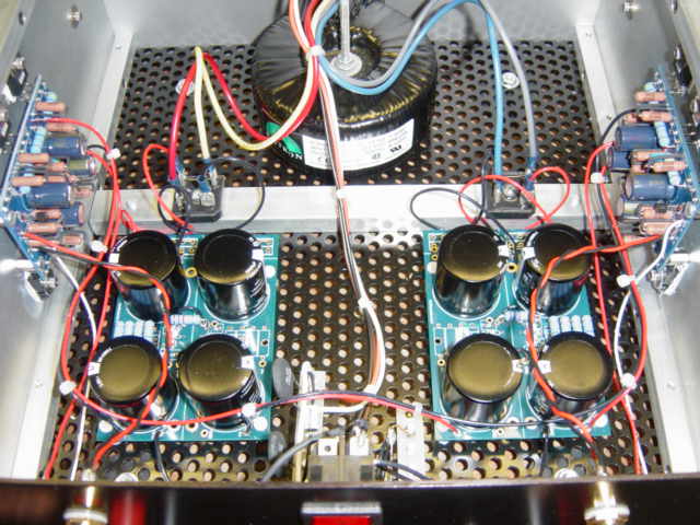

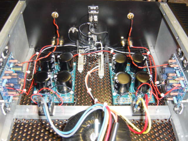

Or disconnect the labyrinth boards and try a simple lytic bank with a few wires to see if the CRC mumbo-jumbo is causing the hardships.
(might have been wiser to jumper the CRC boards at the front and the back instead of playing crossroads. Tom Waits in the Fisher King : Whoop, Whoop, now boarding for the Ground Loop Express)
