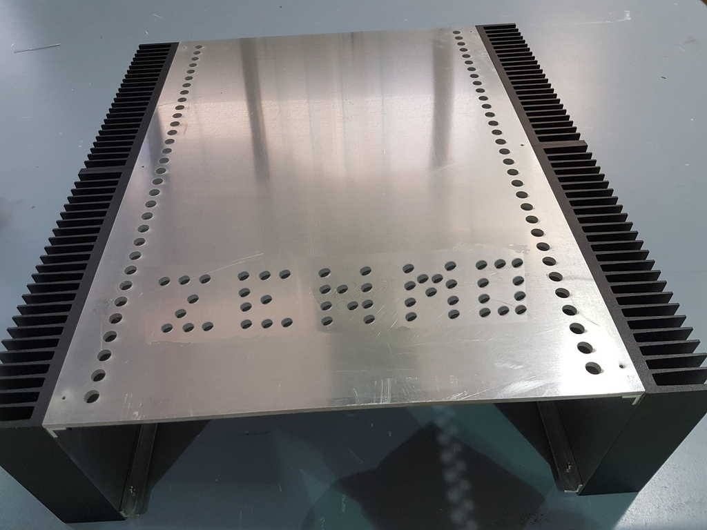

I'm sorry I didn't have enough room for the D.

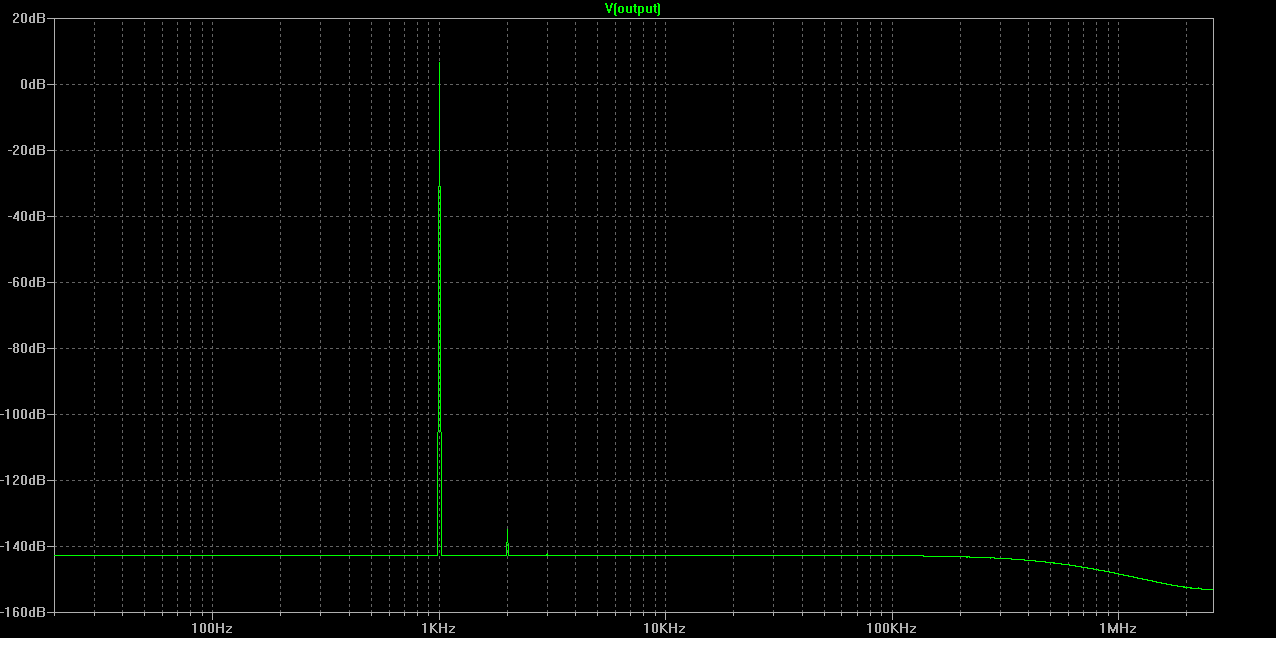

And pr showed me the way to make a rectangle test with Spice for the circuit with a 1uF cap at the output and with the combination 1k gain resistor and 10k feedback resistor for 20dB the result looks like this.....

Is it OK to use such high values of resistors in the global feedback loop? I was under the impression that one should keep feedback resistor values low in a current feedback amplifier.
EDIT: the 1k and 10k, I mean. Standard values from the Sony VFET2 are ~100 and 750.
Run some simulations and look at the Bode plot with the AC stimulus in the feedback loop. You will see that the -3dB frequency increases as the feedback resistors are lowered. Also be sure to look at the phase and gain margins vs. the feedback loop impedance.
Yes, I ran a couple simulations earlier and noticed improved phase and gain margins. Will have to adjust local feedback levels, or I won't have enough overall gain.
I just seemed to recall something about needing low resistor values for current feedback amps, but don't remember why... Maybe it was from working with high-bandwidth opamps...
