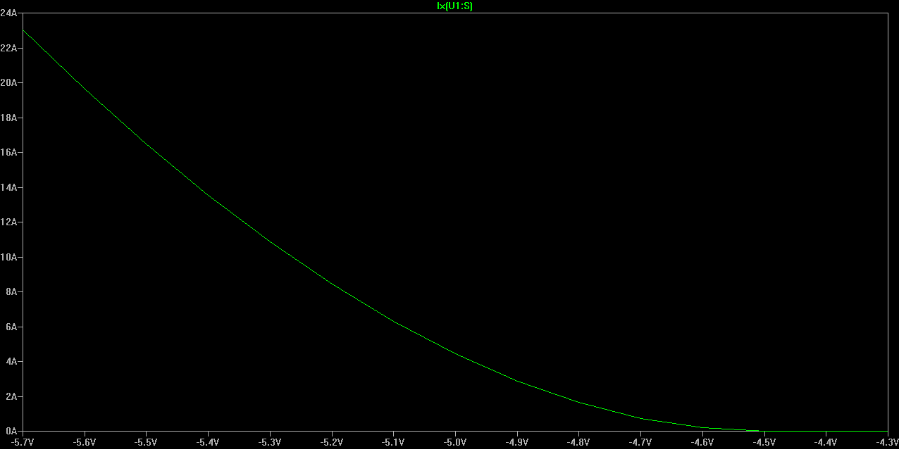

That is not really enough though, I want to see if they produce curves that are representative of the raw part or not.
yup
and as I said before - I'm not exactly looking for skinned cat ...... I'm more about ways to do it
I need to finish this amp first. Once complete I will be happy to go back and entertain some of these other fun ideas. It is always fun seeing what tricks Papa has up his sleeve.
At the moment the bias circuit works perfectly (well good enough). I will video it's behavior.
Is this what you wanted to see PicoDumbs?
