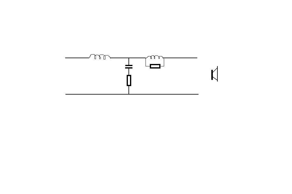

I have used a "notch" on my bass (3way)
After reading that a notch introduce ressonance, I tried to do like Zaph and removed the resistor, but I didnt like it
Then I tried to remove the cap and it proved much better
I ended up with simply a coil and a big resistor(39ohm), much like its often done to make BSC
It is very clear that some high frequency ringing has disappeared and sound is now much nicer, soft and smooth
Offcourse its not in general and must be system related, and in this case its a notch that works outside the passband of a bass
I think its remarkable that a notch on a woofer can cause high frequency ringing in the whole system

I have to say that the coil and resistor is placed AFTER a "traditional" 12db filter (series coil and paralel RC)
And my finding may be influenced by flawed woofers, or other things
But I am quite certain that filter Q values are VERY important and have huge influence on transient response - someone has mentioned it to be more important than smooth FR response

A bottomless LC notch filter always causes a maximal amount of ringing (or a bump as I called) right next to the intended notch frequency. So care is needed in using this circuit. When used in a frequency range where a woofer's response is rolling off for a target slope, the notch frequency should be high enough so that the roll off due to a series inductor can suppress the ringing at least by 30 dB down from the speaker's reference SPL. This is why an LC notch is used with a metal cone whose breakups are located at a high frequency. In this case, the larger the capacitor of LC is, the better the situation is. The reason is that a large capacitor also contributes to a faster roll off. This is why a metal cone with an LC notch is not appropriate for LR2 design, but for a higher order filter.
So, it all depends on HOw it is used. I think your intended filter slope were shallow (because you ended up with a series inductor and a big parallel resistor). This indicates that the capacitor in your LC notch was not that large. In this case, the bump caused by the filter should be audible.
There is nothing wrong with using a knee in the transfer function of the filter to correct the acoustical response. It will store energy, otherwise you couldn't get a knee. Look at the final CSD of the system to confirm that it isn't a problem.

Nice, ... or could it be because my LC was a paralel notch (in series with the signal) ?

Oh, I misunderstood that you used a serial notch. But what I said about the use of LC notch filter still holds. But the role of capacitor in the LC does no longer applies in your case. Anyway, basically you ended up with a sort of electrical 3rd order-ish topology (not exactly 3rd order because you used a resistor in parallel with a coil). Right?
BTW, a very interesting way of using an LC notch filter is using it to achieve a steep slope filter. In the case of serial notch filter (just the case you tried before), we can add a shunt capacitor to look like an electrical 4th order filter. This removes the notch filter ringing and makes a very steep filter. In the case of a parallel notch, we can add a series inductor to make it like an electrical 3rd order filter. This also suppresses ringing to achieve a steep roll off.

but to get it straight my bass filter now looks like this, and what it is I cant tell without measurements, but it works pretty good ... it might be useable in midrange too
