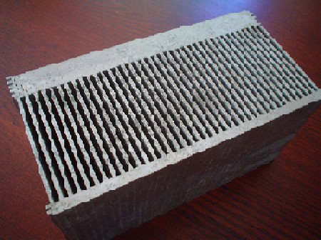

For Mr Green,
the heatsinks for the ExtremeA, had to wait quite a bit for these to arrive.
Modular sinks, 39 extruded profiles with slots which are pressed together.
The sinks were used to cool huge IGBT's, able to deliver +250 amps each, in welding machines.
Comparable with the heatsinks used by Tom Colangelo in the Viola power amps.
These require a revamp job before mounting them inside a chassis ; a repressing of the extrusions under a professional press, grid blast, accurate grind levelling of the device mounting area and anodising.
Really heavy bricks.
