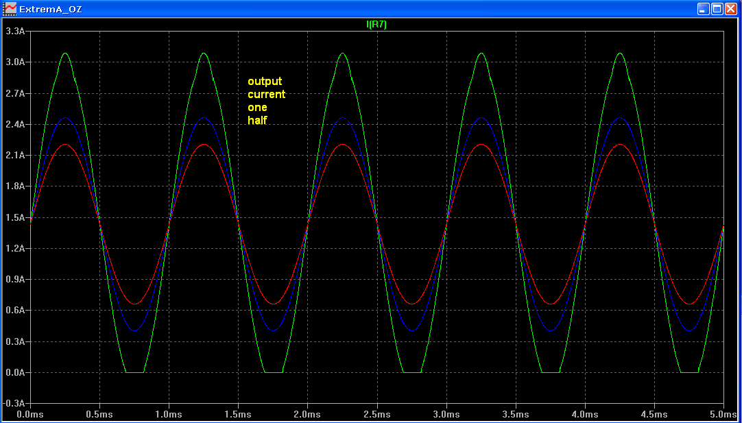

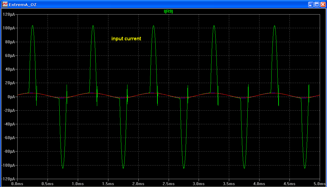

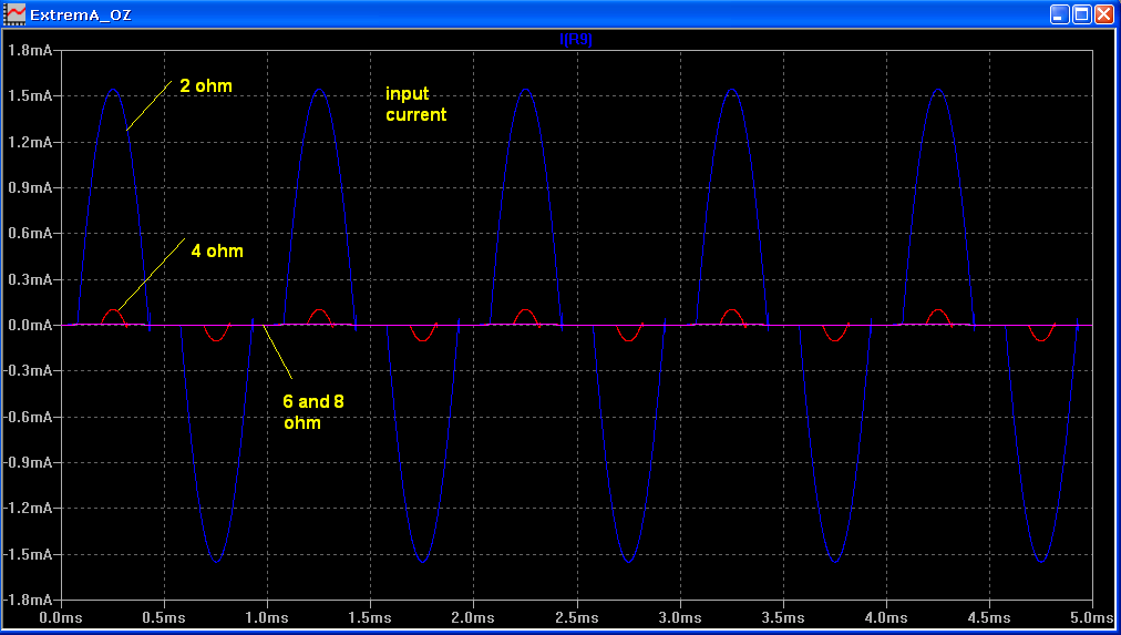

No load on the opamp is great as that was the last area of concern (OPS loading) for using opamps. How much current does the sim say the opamp must supply (max) when the amp goes out of class A?
THx-RNMarsh
Not nice, then. Starts quite mild, as attached, but continues to milliamps and tens of milliamps.
The image is for stepped load 8, 6, 4 ohms. You can see input current and ouput current through one output device.
added an image for 2 ohm load
