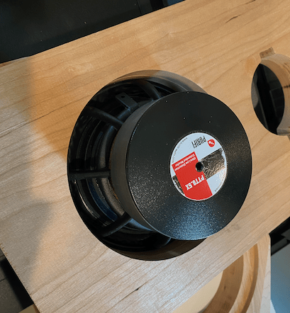

I hope this is a reasonable place to pose this quick question (or two)...
This is a Purifi PTT6.5X04-NFA in a 38 mm (1.5") thick baffle. The through hole is 145 mm. I was planning on chamfering the back side at 22.5 degrees. But this looks like plenty of space. Does it need more space to breathe?
Related to this, I've been thinking about isolation approaches to driver mounting, some of which are a bit easier to accomplish using through-holes on the baffle with the back face of the baffle being flat where the holes come through. Thus, the question of whether a back chamfer is needed. I get the sense here (including Lars' post #1780, counseling to torque mounting screws properly and focus on other aspects) that driver isolation might not be worth the trouble. I may have some isolation of the baffle from the enclosure because this is a solid wood baffle on a plywood box, and so the baffle will be gasketed and retained in a manner that allows for small movements. Any guidance?

If you can, give it the chamfer. It's not just about breathing, but about minimizing a pipe resonance due to the thick baffle.
