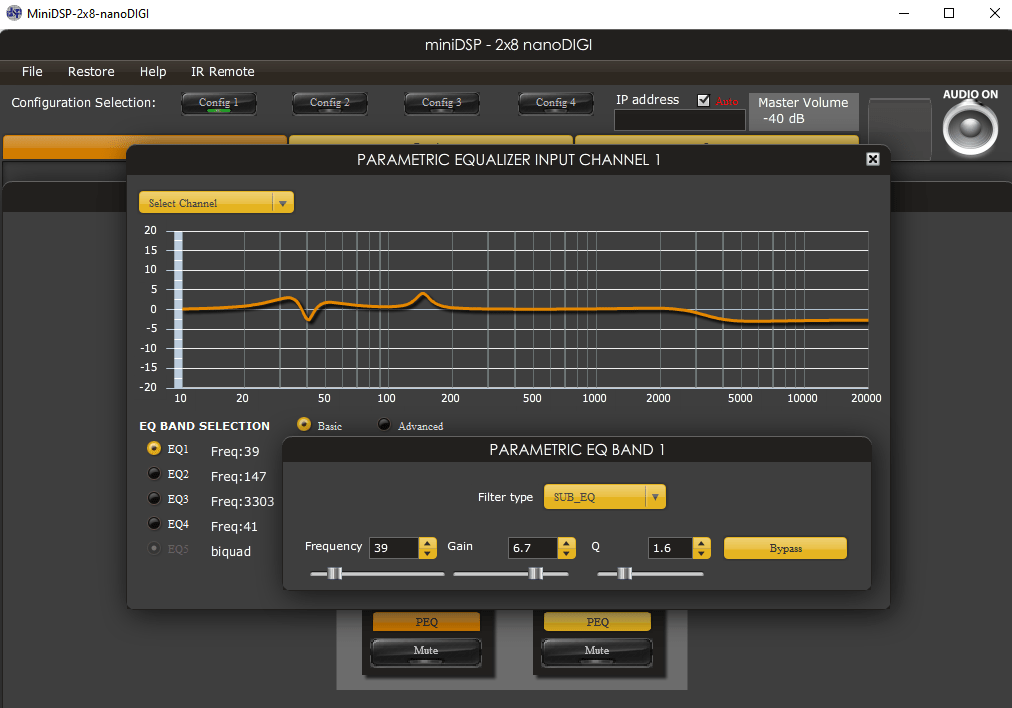

For this tale each bass system is the Purifi powered speaker I call the Fi12 the ‘12’ denoting enclosure size 12 liters loaded with one PTT6.5W and dual PTT6.5PRs. Tweeter GR Neo3 horn loaded. Crossover and EQ (more about that EQ later) Danville Signal audio DSP setup as bi-amp into four channels of ACG 1000 amplification. Crossover and EQ set for 6 dB/octave crossover @ 1800 Hz 0 dB tweeter attenuation, used with analog attenuation on tweeter feed. Woofer EQ +10 dB @ 20 – 60 Hz and +3 dB @ 20 – 200 Hz. Tweeter EQ +1 dB @ 10 – 20 kHz.
Yes, these early days down in the foothills of the DSP learning curve we have a configuration that has a big old bunch of bass EQ. Digital and analog gain match the horn loaded planar tweeter to the PTT6.5 and addresses a 1 dB droop between 10k and 20k Hz. The +3 dB 20 – 200 Hz is intended as baffle step correction. The +10 dB boost across 20 – 60 Hz is a deep bass extension experiment. Not unexpectedly this DSP program is bass heavy compared to flatter response configurations.
Any experienced listener would recognize the bass heavy tuning of this DSP load. And many listeners would recognize it as very much big time fun. The little PTT6.5W and PRs got to it sounding like the fat muscular sound of an Altec or JBL 12-15” woofer in a refrigerator sized reflex box. I was also reminded of the typical too high bass levels used when subwoofers are first added to an audiophile grade HiFi rig. During the new toy honeymoon period extra deep bass after which the sub’s gain is adjusted down to a flatter level more in tune with a goal of balanced HiFi reproduction. Nonetheless I lingered in the bass fat land of the lotus-eaters.
With typical music and video sources the EQ boosting frequencies below the driver/enclosure system tuning added explicit first octave bass like what one gets with subwoofers or very large enclosure volume 3- or 4-way speakers.

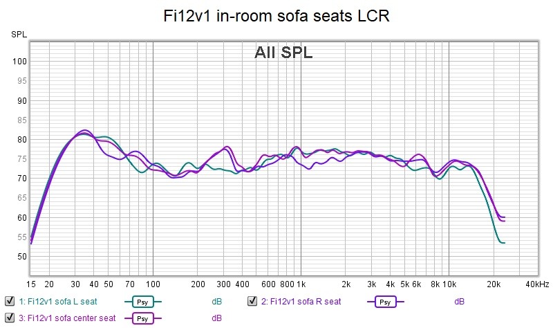

Graph below shows in-room response of the Fi12v1 thus configured. The 30-50 Hz boost is a room mode, mentally subtracting that room mode see the –3 dB is 20 Hz. The weeks (yes, so much fun for weeks) this configuration was in place in my listening room that response to 20 Hz made its presence known while playing music with organ and synth we audiophiles catalog containing sub-40 Hz bass. Playing movies, the low frequency effects in action adventures and the very low frequency tones added to enhance tension lit up the room with power.

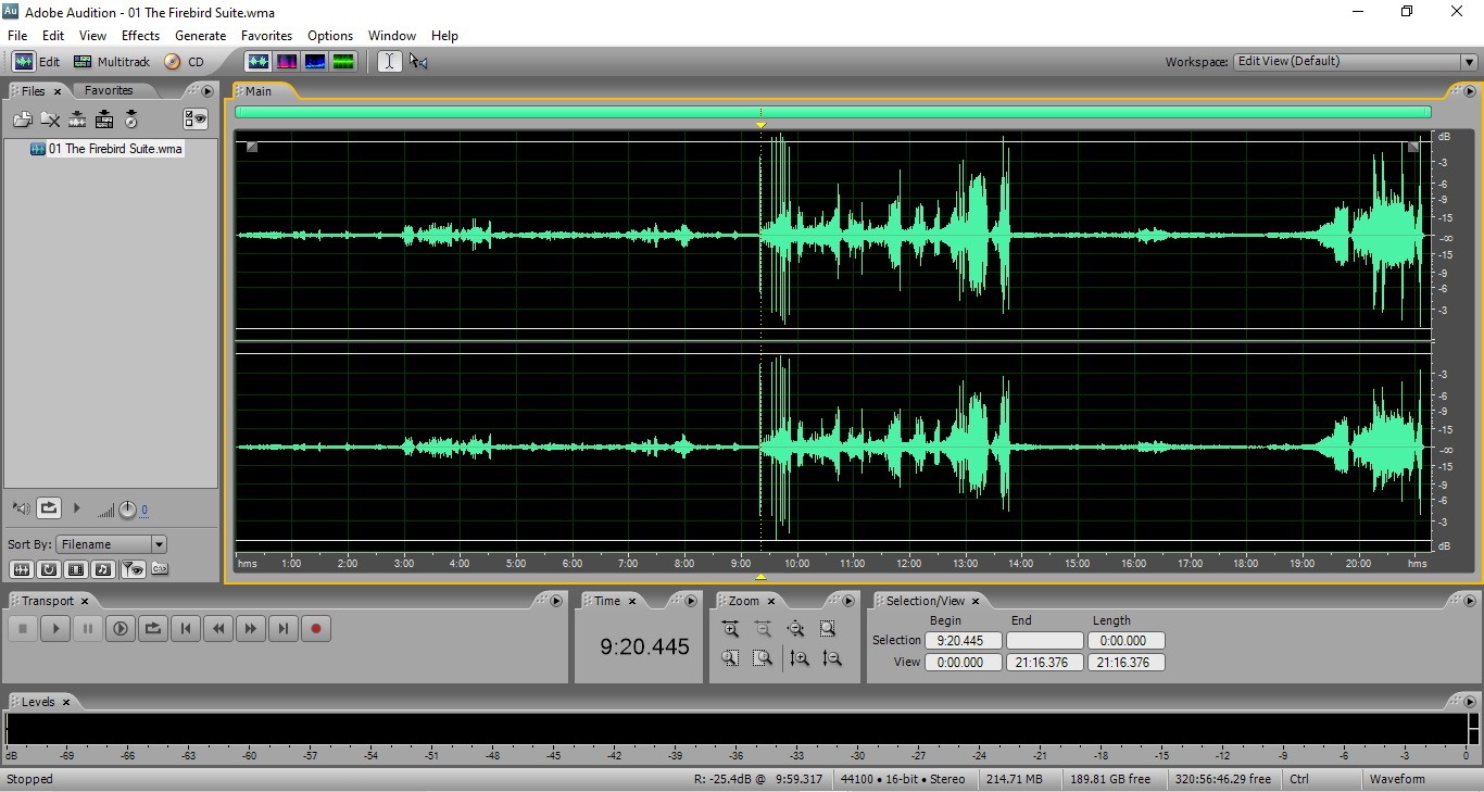

Specifically, the recording Stravinsky: The Rite of Spring performed by Minnesota Orchestra conducted by Eiji Oue on Reference Recordings catalog number RR-70 (https://referencerecordings.com/recording/stravinsky-the-rite-of-spring/).
During Thursday HiFi night my friend Michael requested the Eiji Oue Rite of Spring.

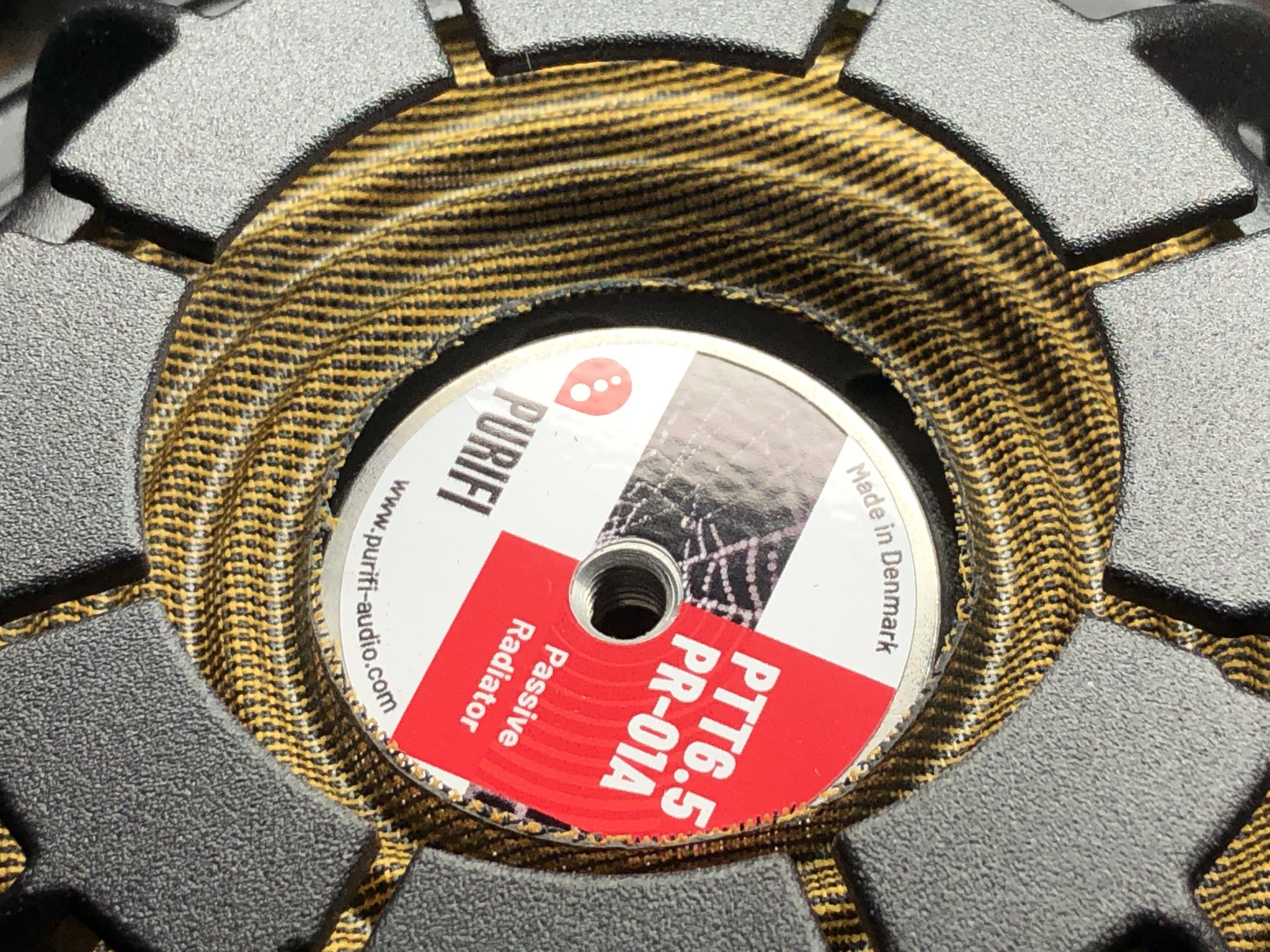

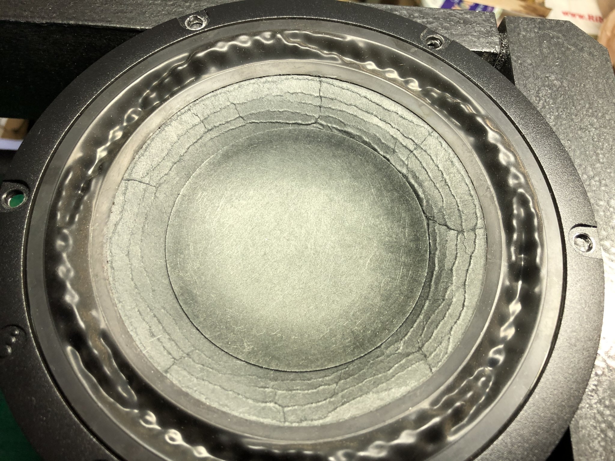

I was not that familiar with the performance so when it started very quietly, I increased the volume to bring the level up to 70-80 dB. It’s a wonderful recording and all was well for the first 9 minutes, then the orchestra, including massive drum whacks, goes from quiet to triple fortissimo the level instantly jumping many 10s of dBs as the percussion section wails on their drums. Before it was humanly possible to reduce levels the Fi12s were making very un-musical noises of extreme distress. Got playback stopped and surveyed damage. No voice coil rubbing or other damage to the woofers, amazing. Passive radiators did not get away similarly unscathed. All four PRs had suffered creased cones. Later disassembly found one PR had such extreme excursions the inner spider detached from the mass slug.
Not a happy result. Purifi makes very rugged drivers however there is a limit. The photo of the front side creasing makes the cone look flattened, that is not the case they still have their original dish profile. The extreme excursion creased the cones but they did not tear. Using medium thickness CA glue the one detached spider was reattached. While the creases activate my audiophile obsessive tendencies truth is with the one PR’s spider repaired and the four PRs placed back in service the Fi12s sound fine.
Part 3 – Post crash analysis.
With crystal clear 20/20 hindsight it is easy to see my attempt to turn the Purifi PRs inside out resulted from both operator error and design oversight. Operator error playing dynamic material at too high a gain setting. Design oversight implementing EQ boost below Fs without complementary dynamic frequency specific limiting.
I have been around the audiophile music block more than a few times thus should have questioned what the dynamic range of a Reference Recordings recording of a large classic war horse might contain. Further investigation shows RR-70 is truly extraordinary in this regard. The following two images are the track loaded into Adobe Audition with the dynamic range shown on the waveform display.

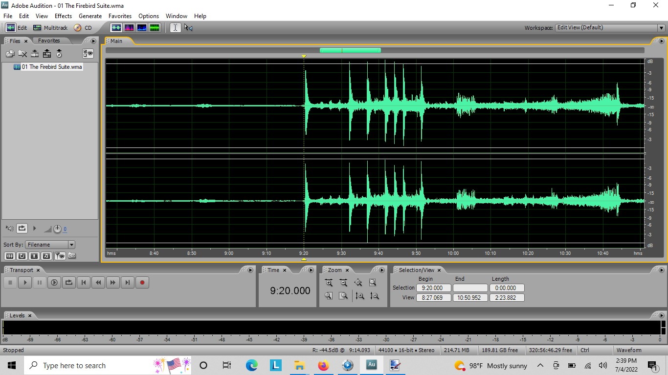

This display shows all 21 minutes of the movement, notice the first 9 minutes average –30 dB with louder sections at –20 dB. Then at 9 minutes 20 seconds all hell breaks loose and levels jump to –3 dB!
The second Audition screen capture zooms in to the couple of minutes before and after the dramatic jumps in levels. Playing the track in Audition the music before 9:20 is averaging –25 to –35 dB then when the triple fortissimo with drums hits at 9:20 level jumps to –3 dB. A 32 dB step change in output in the bass into a system with 10 dB bass boost using an amp capable of a kilowatt into 4 ohms, what could possibly go wrong? :cool: What I find so very impressive is the woofers took such thermal and mechanical abuse on the chin and survived. The PRs, well like a race car a pit stop after wall contact was required and we have some dings but they too race on.

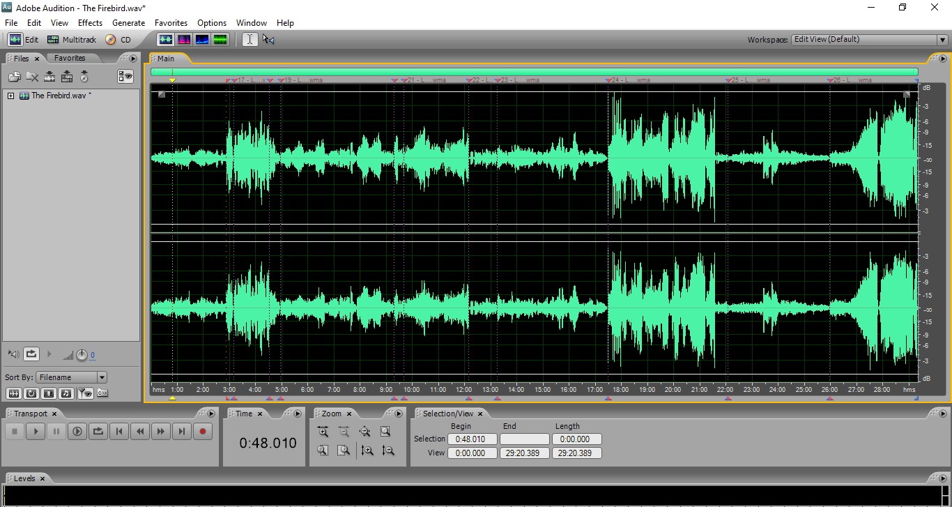

As an example of just how the much an edge case the Eiji Oue RR-70 Rite is here is an Audition capture of Stravinsky conducts Stravinsky on Sony Classical.
With the quiet vs loud parts of the piece at different times it is apparent this is a different arrangement. Here the point is that the quiet parts average -15 dB, at least 10 dB louder than the Reference Recordings version by Oue. The Sony recording has good dynamic range, the RR truly exceptional in this regard.

A good point to paste a sentence from my original post that is key to this discussion. About the DSP system driving this system I documented its settings. “Crossover and EQ set for 6 dB/octave crossover @ 1800 Hz 0 dB tweeter attenuation, used with analog attenuation on tweeter feed. Woofer EQ +10 dB @ 20 – 60 Hz and +3 dB @ 20 – 200 Hz. Tweeter EQ +1 dB @ 10 – 20 kHz.” If you are new to speaker design or missed it in my verbiage on first read that is what is technically known as a ‘crap ton of bass EQ’.

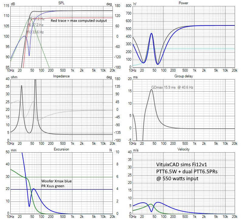

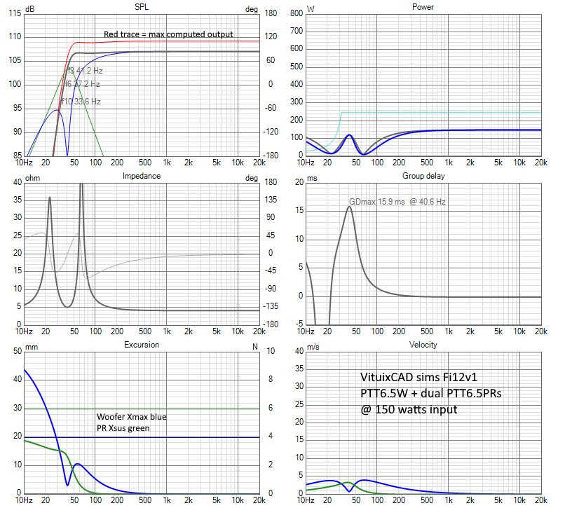

Honoring the high technical level we enjoy on diyaudio.com lets dive into it a bit more. The following can be summarized as Lars wrote “Everything has a limit of course”.
This system used early production paper cone PTT6.5 woofers and passive radiators, woofers 4 ohm models. Each speaker used one woofer and dual PRs in 12 liter enclosures no added mass on PRs. Let’s look at the simulations of that system in VituixCAD for normal and overdriven scenarios. For these sims I did not include the DSP bass EQ, rather looking at the acoustic engines’ capability and then mentally add the extra stress added by so much EQ.
First used within proper conditions. Set at 150 watts input we are looking good, notice in the upper left SPL frequency response graph everything is below the red ‘redline’ trace. On the lower left excursion graphs the PRs are below max all the way down to 10 Hz. A 150 watt input below 30 Hz crosses woofers’ Xmax. I interpret that as good to go with 95% of all music in domestic settings, keep away from discos or the trip wire explosion in Sam Mendes’ ‘1917’. Pause and consider, it’s a 6.5”/165mm class driver absorbing 150 watts and replying “OK here’s your 107 dB output”.
Now overdriven. Recall in this bi-amped prototype I used ICEpower 1000ASP amps rated 1000+ watts into 4 ohms. Combine the deep bass on the recording, excessive setting on the preamp that night, and bass boost and it’s a guess just how big a pulse hit the drivers. My guesstimate for this discussion 550 watts. First problem is that 113 dB output, well above 109 dB max for this system. Next look at the excursion plot, I like how the woofers excursion line is trying to go vertical. :cool: In VituixCAD I read that as peaking at 85 mm @ 10 Hz! We also see the passive radiators’ going over its max limits. And if we speculate at failure the system was seeing more like a kilowatt that sim (not shown here) shows the PRs over excursion at all frequencies below 50 Hz. That is no bueno.
Final summary, this is why I want to get my hands on a few PTT10.0s!

In Norman's sim, the 6.5" driver is pushed with 550W and it (theoretically) makes 113dB from 40Hz up... I still think that it is too much asked for a single 6.5" woofer! When tuning is 49Hz, this leaves also lots of movie rumble effects below 40Hz
