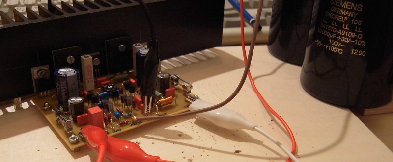

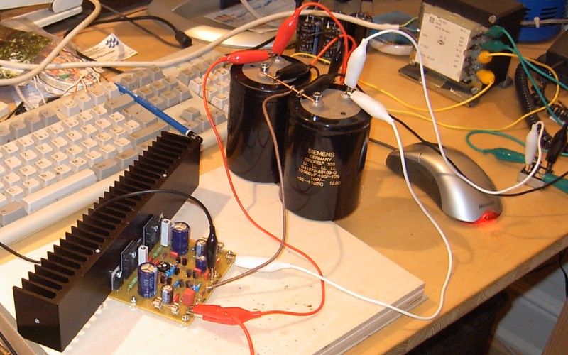

12 Cents said:Now I wired up a better PSU -> ah, better.
Q: What happens if I leave out C14 completely? Cause that's just what I did.![]()
Unfortunately it might not be that simple to disconnect that feedback capacitor. Few days ago I added Bode plot stability explanation to my "evaluation page"
http://web.telecom.cz/macura/symasym.html
Please read it carefully and look at the Bode plot image. Disconnecting the feedback cap may lead to very low phase margin (blue phase curve, close to non-stability point, danger of oscillations). I would always connect a small value of the feedback cap for the Symasym circuit, say 3.3pF - 6.8pF.
Pavel
Well, I did not mean to do so. In the end I specially bought my MJL3281A and MJL1302A from ebay dot com. I just left the choice of feedback cap until I forgot completely... d'oh.
Anyway, two channels are up and playing and I'm fine for the moment...![happy2 :happy2: :happy2:](https://files.diyaudio.com/forums/images/smilies/happy2.gif)
Now I have to look for a bigger transformer, think about housing etc.
