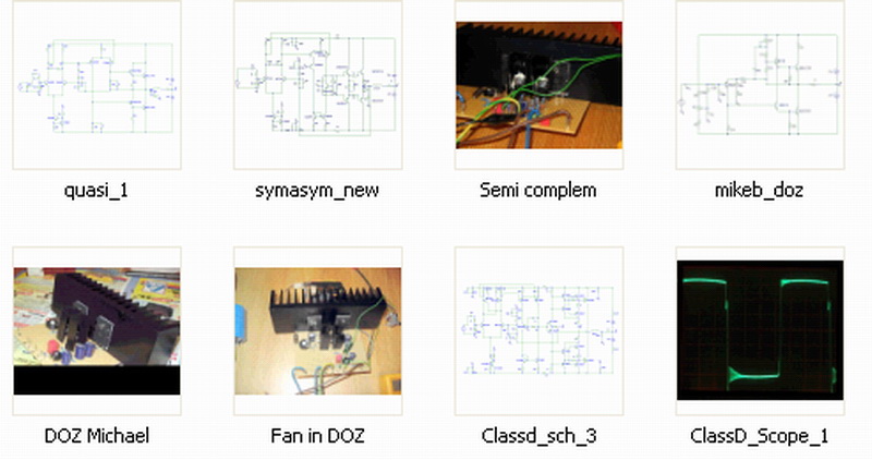

This one is strange too, sometimes the way people make the schematic
Some non standard way to draw differential and others usual circuits, produces the appearance that is a different amplifier, when studied with more attention, we can see the same traditional couplings, designed in other spatial position.
Thank you, this Dynaco is very interesting.
I will print it all, to have fun trying to understand it.
Thank you EVL or EDL, the guys from Paty, that made the kindness to post the link.
Will print now...thank you.
regards,
Carlos
Oh! Epupa, i forgot to comment your information, that the design was founded in the..
Design of the seventies.
This produces to me, the confirmation of some suspections i already had.
That no one can produce something really new, because we are very poluted by the diagrams we use to see, and ideas we use to read and listen.... so, alike some noise in comunication, the noise in amplifier design may be this one... the memory of others for instance.
Or that everything you can imagine, someone probably, had the same idea, before you, or at the same time...we are no more isolated one each other....communications make things obbey some universal rules; connected to majority, price, reliability and quality.
Why i confirm to myself, my old suspections:
- I was with Michael, discussing by mail, daily and many times a day, related the best thopologie, my suggestion is that he could start from a Bootstrapped, and them simulate, construct and go researching to make it better than everyone.
- He decided to make his own design, starting from zero, by himself, since the first resistor, and to simulate each stage, watching distortions and wave forms in the Scope.
- Circuits gonne changing and changing, i have more than 15 circuits tested here, produced by him, they were constructed, simulated and compared...one, the evolution of the latter one, till he stopped satisfied with this, as he told me, could beat JLH, the Yamaha he has, a very expensive unit, and one Harman Kardon...he was satisfied, as the bass turns better than the Yamaha, voice and trebles was better than the 2 other ones.
And i could listen, and some friends also...the comparison was recorded... same speaker, same music, same level, 2 amplifiers beeing switched A to B, and recording going on.
This is some evidence that someone can start from nothing (only basic informs and design know how) and design something already done.
This is a little bit obvious, because if you use 35 volts, and decide by a 2 miliamps in the differential stage, you will have same resistor as hundreds of amplifiers, and almost all them use differential amplifiers....so, cannot scape too much of the "samething"
I ensure you all, the guy did not copy (with the purpose) nothing!...maybe, the good polution (old experiences, old memories, circuits he could see after, design books) he received year by year, could result in something already known.
This thopologie, the way was designed (sorry my ignorance) is the first one i could see.
Well, all life seaching amplifiers constructing, 46 years completed assembling amplifiers, more than 3.7K units constructed.... even beeing idiot, i have some experience about the subject, at least i watched many schematics.
In my computer, for instance, 3612 schematics are saved... and they are in 47 groups of different designs, different thopologies... but i have not all world schematics...this Dynaco i had not, for example.
And i was asking him (Michael) to copy, to start from something already considered good, not to loose time climbing stairs already climbed, not to re-discover the powder without smoke...but he finally insist to do everything by himself...since the first step.
But you have the rigth to observe similarities, also Hugh Dean, from Aksa, told us that he could see someone alike, made by Sanyo in the seventies, so...you may be rigth to observe that and to find some schematics that look alike.
I ensure you, this schematic, published, was designed by Michael
regards,
Carlos

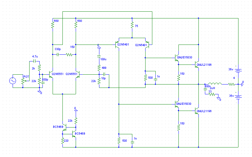

Michael started with this schematic, and i was following very close, as he asked me
To help him with the listening tests, he wanted to have a second, a third and a fourth opinion.
I have in close contact with him, since the intention to design his own amplifier, the first one was made with 21 Volts Symetrical, using BD139 if i can remember.
Everything was developed, step by step.
He also decided to construct some JLH reference amplifier, and the selected to show some JLH quality, was DOZ, because simple, fast to construct, inexpensive, and showing the JLH main characteristics.
He used this one as a reference, together Yamaha and Harman Kardon.
Many circuits were made, including a class D he designed because i asked him...he turn very tired, working 4 ours each nigth, and heavy work all day long...i got up and he got up too
Those schematics, that i will have no intention to publish, because all them superated by Symassym4 and Evolution 1 (symasym 5) were use as references to decide for a new aproach...and he never decided nothing by himself, many people was consulted about that, Including the King of Australia and the Baron of Saint Ivy...both of them with Gold titanium Berilium Diamond ears...the baron waste 40 years of live inside Professional Studios, learning day by day, how incompetent can be manking, including inside BBC Broadcasting Radio Studios.
The guys did not copy anything boys...he is really gooooood!
regards,
Carlos
Yeah!..nobody told he copy nothing, but the accident, the simple existence
Of alike schematics, having some similarities, already represents, by itself, a finger pointed.
So, i decided to be very, very clear.
here is some images...just a small part of the ones i have, of his steps of research... 3 monthes, 4 hours each nigth..the one loose weigth and had some disease because of the effort, and small time to sleep
regards,
Carlos

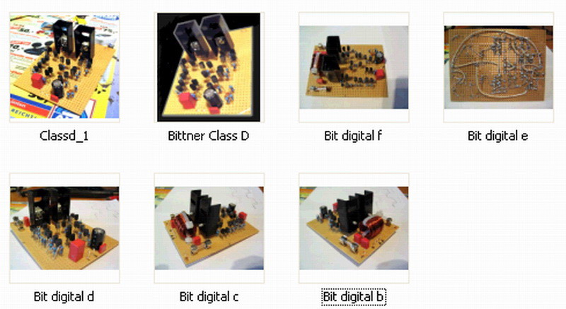

Here some more images...last one.
Was terrible to me, this guy appeared from nowhere... saying that was a computer programmer and will design an amplifier...
- I said:
WHAT!!!?
- And i want your cooperation Dx.
Was hard to me, having age to be my son...knowing three times more than I could learn with my gray hairs...having studied in Japan and worked for Sony
What a hell this chucrute!..how deer him, not beeing and EE, came here and say that will do that difficult job?
He made...he really made, i am testimony...hard to me in the first days...recognize, that this boy...very young boy related my age...he is really GOOOOOOOOD!
regards,
Carlos

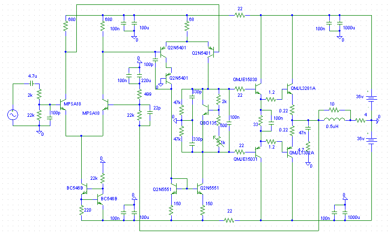

Hi !
Okay, time for some details about this amp:
I like this amp, it's "easy" to build, no complementary
transistor matching is necessary (except outputstage),
no exotic and hard to get vas-transistors, very
reliable, low DC-offset, excellent thermal stability...
My impressions about the sound:
Very clear, transparent, detailed and alive sound, and
frightening dynamics, the amp plays effortless at high
levels, having good control over the speakers resulting
in very tight deep bass.
Voices are reproduced like with a DoZ, simply stunning !
Guitars and pianos are a real pleasure...
My biggest surprise was the soundstage, that wide that
i checked speakerpolarity at first powerup, but when
listening to music, every instrument was pinpointlocatable.
And now, the numbers !
All values taken from sims...
Max swing at 4ohm: 32.6v (133watts)
Openloopgain: 1:32000 (gbw: 237mhz)
Closedloop: 1:45 (0.7v drives amp to max)
Feedbackratio: 57db
TIM: ~0.003% (4+7khz)
Slewrate: ~19v/us
Dampingfactor with outputcoil:
20khz into 8ohms: 120
1khz into 8ohms: 2400
100hz into 8ohms: 12000
Dampingfactor without outputcoil:
20khz into 8ohms: 6000
1khz into 8ohms: 12000
THD-values:
2.8v into 4ohms 20khz: 0.005%
2.8v into 8ohms 20khz: 0.004%
12v into 4ohms 20khz: 0.008%
12v into 8ohms 20khz: 0.007%
28v into 4ohms 20khz: 0.023%
28v into 8ohms 20khz: 0.016%
2.8v into 4ohms 1khz: 0.003%
2.8v into 8ohms 1khz: 0.002%
12v into 4ohms 1khz: 0.002%
12v into 8ohms 1khz: 0.002%
28v into 4ohms 1khz: 0.019%
28v into 8ohms 1khz: 0.007%
I personally believe that thd-levels below 0.003%
for a poweramp are nonsense, this represents the
resolution of a single bit from 16bit-CD.
I also attached "symasym5", using slightly different
feedbackcompensation. This versions gives a softer/sweeter
sound, sounding more precise, revealing even more details...
Carlos did not like it, too soft for his taste ?
THD numbers drop slightly for no5.
Soundstage becomes slightly less wide, but deeper.
And yes, i know that this topology is not new...
(But it's a damn good one !)
Michael
