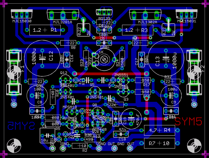

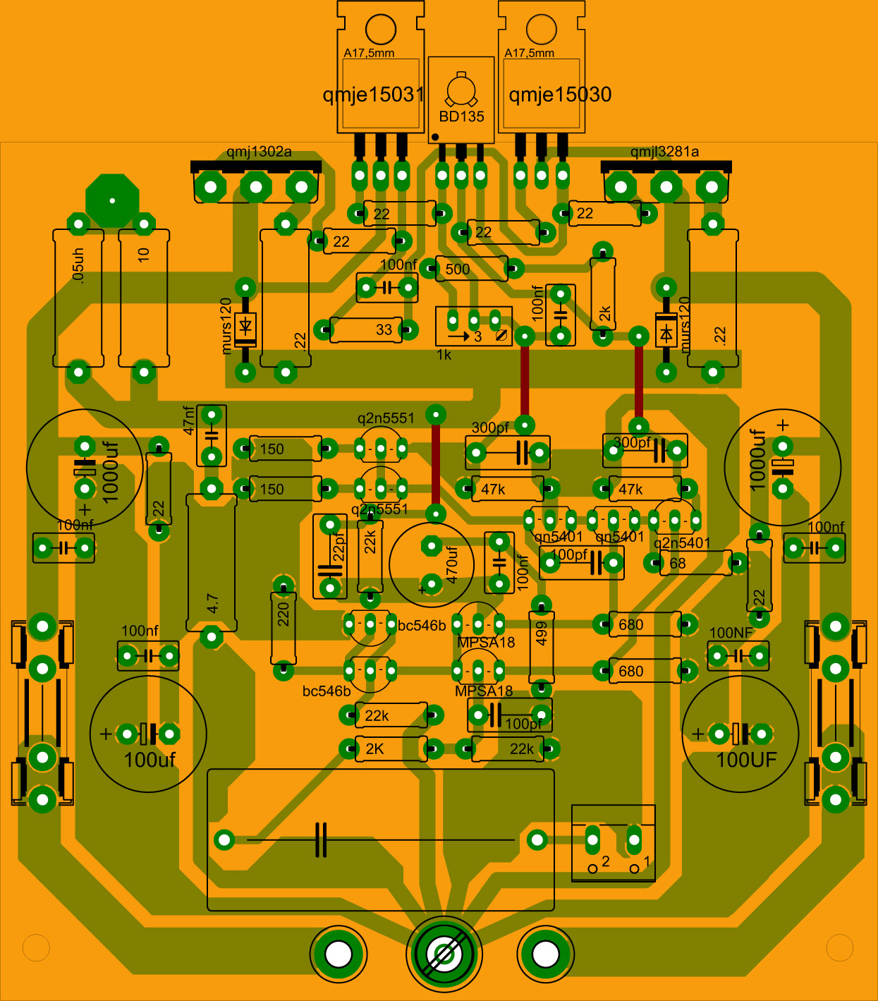

got this from M.Bittner site. same version with last thread why so many to92?
regards,
joel
I´d say nine,just as it should be....
he he
It could be an optical illusion,the way that they are spreaded on a pcb. I thougt the same thing before i counted them one by one. I have done SymAsym 5.3 and first thing i have noticed that is different on your pcb than on my is two diodes between E and C of output transistors. MURS120 exists on your pcb and on my they are not provided. It works anyway!

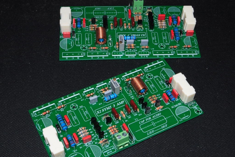

regards,
joel
I couldn't locate where that pcb is from. Can someone direct me to the site where the pcb above sold? Thanks.
