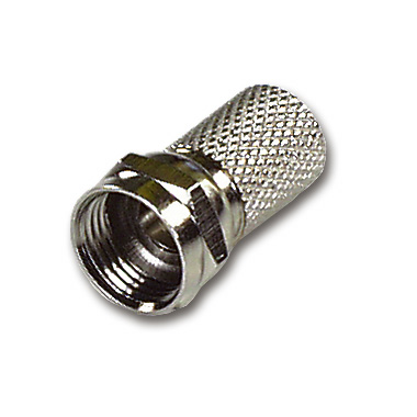

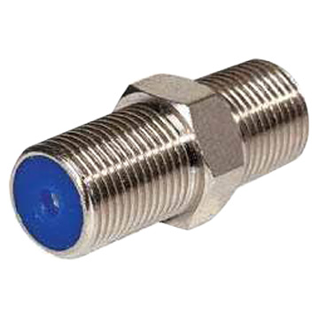

Some things I pieced together from my surfings (so you might wanna check!).........
if you're making your own connections on both ends - Use F connectors ( same as on cable & SAT/TV lines) ;
that way - terminating is easy , and good quality antenna cables are cheap
if they're good for long SAT signal runs , they're certainly good for SPDIF
use F "kuplung" for chassis mount

Coaxial SPDIF out of machines is 75R impedance and as such needs the correct cable and BNC connector. To my knowledge it has never been 50R impedance.
I strongly suggest either 75R BNC or "F' types with preferably double screened cable either Satellite cable plus 'F' types, or preferably UK Broadcast cable type SD01 with matching BNC plugs.
SDO1 is good up to about 360Mb/S so should be OK for SPDIF:D
Phono plugs are a compromise as they are neither 75R or 50R impedance nor are they constant impedance with frequency. The main reason for use is naturally cheapness.
I am not quite sure where this idea of long cables for SPDIF comes from (Snake oil?). As long as:
a) It comes from a 75R source
b) It is terminated in 75R at the destination and
c) You use the correct cable/plugs as above
It will not matter whether it is 5 cm or 20 Metres long.
The 110R impedance spoken of is generally reserved for AES/EBU balanced cables, using XLR type connectors, for sending digital audio signals around mainly professional audio and broadcast studios.
