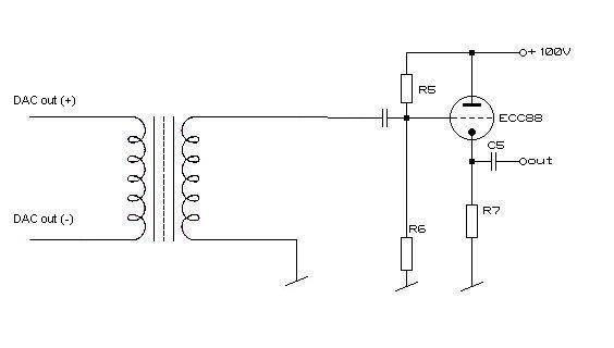

Similar reasons make me to attach to transformers output a tube buffer like that:

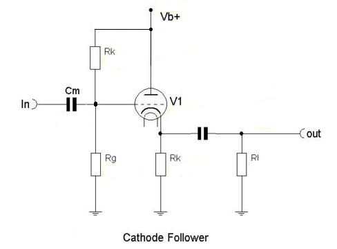

this is the calculation I made for 6N6P. Can you tell me if this is right? Does this means Rp and Ri is not needed?
Is the Anode supply is really as high as 230VDC?
McGyver
No, it's not right. You must use a capacitor at output. Rp is unneccesary. You should do it like that. Calculate it from the beginning.
McGyver
Sorry I don't have the method of calculating the right circuit. Perhaps maybe you can give the formula as a hint for me to correct this circuit...
For the beginning you can read this: triodelesson
The tutorial about triod is very good. But the schematic is different.
from your cathode follower circuit
I found a website similar to your buffer circuit The Tube CAD Journal, August 1999 pg 1
But there's no tutorial and guides for R, I, V calculation like from the link you given. Perhaps you can show us the calculation...!
