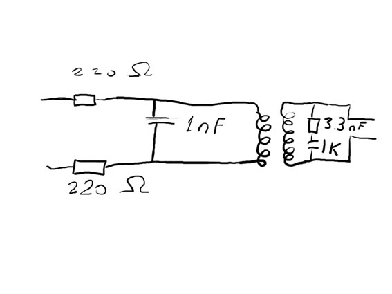

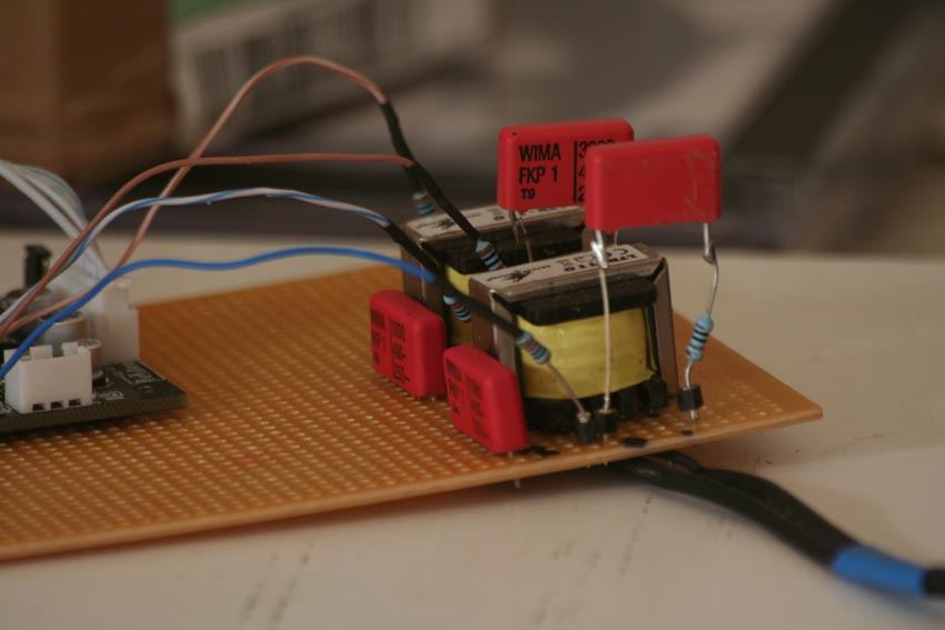

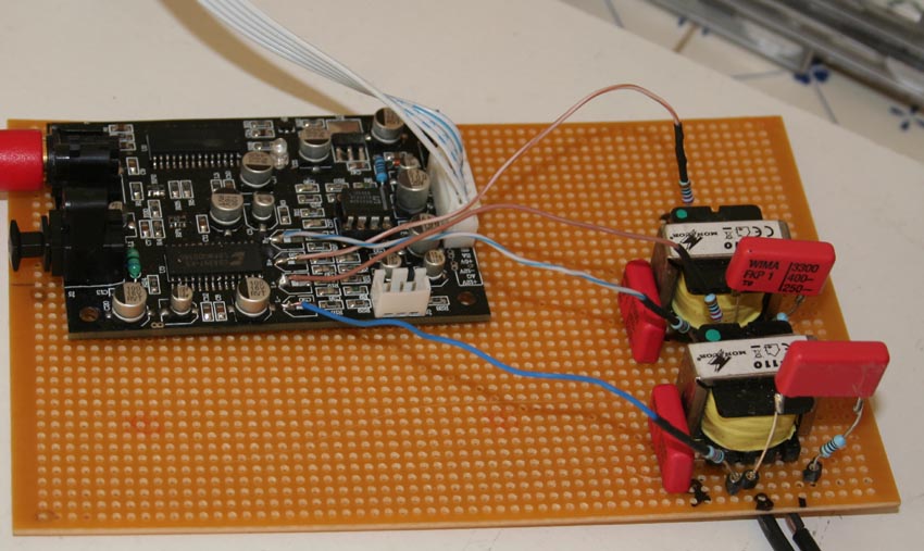

Hi All,
The attached shows how I have hooked up my Monacors to the small DAC.
Caps are WIMA FKP1
Resistors are Beyschlag MBB-SMA
I may one day try other transformers advised on this thread but in the meantime I feel I can choose better components but need advice.
All suggestions welcome.
Caps are WIMA FKP1
Hi Tony,
If your DAC-chip is CS4398 then you can savely remove all those caps and resistors. Less sourceresistance is less distortion, phasechange and better bass. The caps give a very strong phasechange in the treble that you can definitely hear. I'm very happy this way with the monacors. Just curious to find out what happens with better trafo's...

Hi Gerard,
The chip is a CS4397. ??
