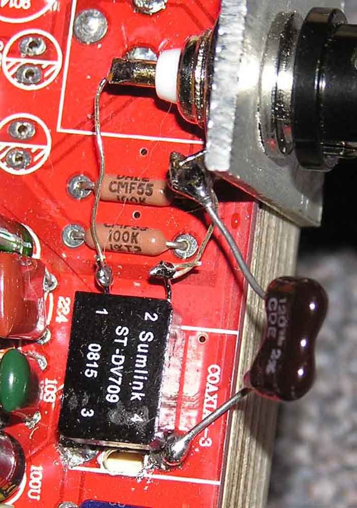

Re: Sumlink ST-DV709 Digtal Audio isolation transformer
Can anybody answer this please.
shuggi67 said:The new board does not have the Sumlink ST-DV709 Digtal Audio isolation transformer, is that going to be an issue I read way back in the thread that it basically renders the S/PDIF inputs weak, I have contacted the seller and she will supply one for $30!! but I can pick them up for under $10 delivered.
what does it do ? will I need it and if so how and where does it go on the new board.
And is there better ones.
Re: Re: Sumlink ST-DV709 Digtal Audio isolation transformer
One of the guys with more digital knowledge really needs to answer this.
The transformer only provides isolation to prevent ground loops and eliminate some trash from entering the digital stream. If your transport has a transformer coupled digital output, and most good ones do, then you really don't need another transformer at the input.
I am going to wire up two inputs with separate transformers so I can switch inputs by utilizing a simple front panel switch. I don't yet know exactly what they are using on the board for input circuitry so I don't know exactly what I need to change or add yet. It sure would have been nice to get a schematic with the board.
Most of the trafo manufacturers,Sowter and Lundahl for sure, make the digital pulse trafos also.
I'm sure someone in this thread has added a digital trafo by now, we need to hear from them.
Best, Bill
I used a Sumlink on my dac. Here is how I connected it.
The Newava S22083 is one of the best which is available for $10 at Digikey

shuggi67 said:Bill, Lagarem
Thanks, that pretty much answers my questions.
Another source for info is the CS8416 data sheet. It shows the trafo implementation for an aes/ebu input, just change the resistor from 110 ohms to 75 ohms for a standard SPDIF input. Notice the DC blocking cap to protect the trafo.
Bill
Bill Fuss said:I have misspoken about the 75 ohm resistor, I'm reasonably sure that resistor is already on the board.
Yes, it is on the board
The cap you see on the pictures goes from the BNC ground plug to the ground of the dac.
The BNC plug goes directly in the transformers without cap between the transformer and the BNC
piero7 said:Legarem, do you suggest to mount this trannie on all boards?
I wouldn't use any dac without this pulse transformer.

piero7 said:
Plase, explain us why technically
Digital gear does RF transmission so an isolation transformer will help to get rid of RF from the transport to the dac.
With the transformer, the sound is mellower, less edgy, seems more natural.
Thanks! I'll sure test it!
THe cap is 120pF?
THe cap is 120pF?
Something near 100pF is ok
