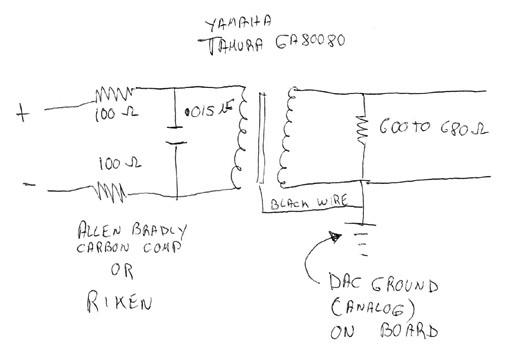

legarem said:
Cirrus use a 50 khz low pass filter on their own evaluation board so I tried this low pass filter with my dac and loved it. The tonal balance is better with the 50khz low pass frequency
Simply use two 100 ohms and a .015 uF cap and it gives a 53 khz low pass frequency.

As the transformer is a 600 to 600 ohm transformer, the 680 ohm resistor shunting the secondary is the optimal load for this transformer and you get near 600 ohm of impedance in the primary.
I never experienced the 'dropout' mentionned when I used 1K resistors. With 1K, resistors, the gain is a little on the low side.
Bill Fuss said:
The secondary load is supposed to eliminate ringing(resonance) but an RC filter does a much better job without loosing as much signal.
Read some of Jensen's white papers on their website, secondary loading is not beneficial to OP transformers.
Bill
With the Tams, I tried many secondary loads with a scope and by ear.
Near 600 ohms I got the best results.

surfstu said:
legarem:
i used your original circuit for the tamuras (without connecting the black wires from tamura), which i appreciate by the way.....
but am i to beleive you have changed the low pass filter now?
stuart
Here is my new setup
Can you describe what's wrong with the sound ?
