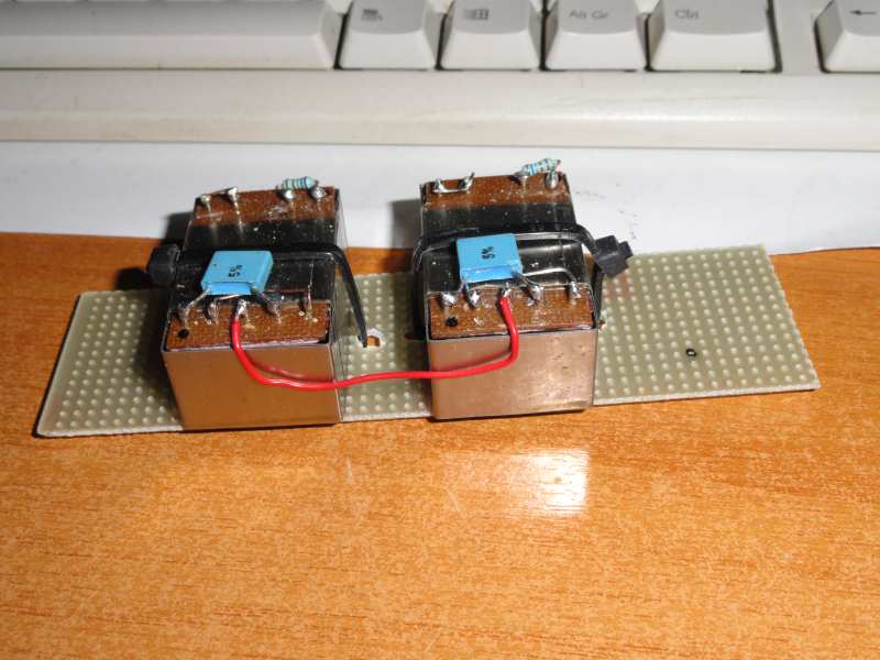

Jensen JT-11-FMCF vs EMCF
I did some listening today between my Jensen JT-11-FMCF and EMCF as configured for balanced to single ended direct out from the CS43122 and AK4395 dac chips. The extra headroom of the larger EM is readily apparent in the crack and slam of the cymbals during the intro to No God from the Extreme, Waiting for the Punchline disc. Darn it. The $66 trannie sounds better than the $50. I was hoping that the maximum levels of the chips wouldn't challenge the capacities of the FMCF or something even smaller and cheaper. Now I am intrigued to try something even better.

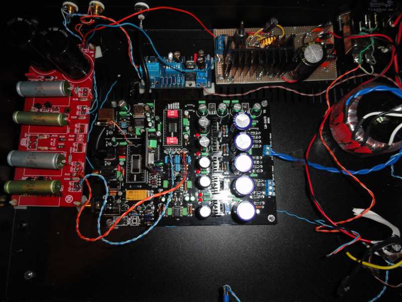

I dream fitting an AK4396 on this chinese board.
CS chips better
The CS dac chips sound better than the AKM. At this point, unless an exotic I/V stage is used, in my experience a direct out CS chip will also sound better than the PCM chips even though they have a huge cult following. I have had PCM63, PCM1704, and now tried a quickie I/V with the PCM1798 and none have rivaled the transparency of the CS43122.I dream fitting an AK4396 on this chinese board.
Couldn't float
Ps. I tried to leave the single ended ground floating but had a hum so I had to connect one leg of the secondary to the dac ground.
