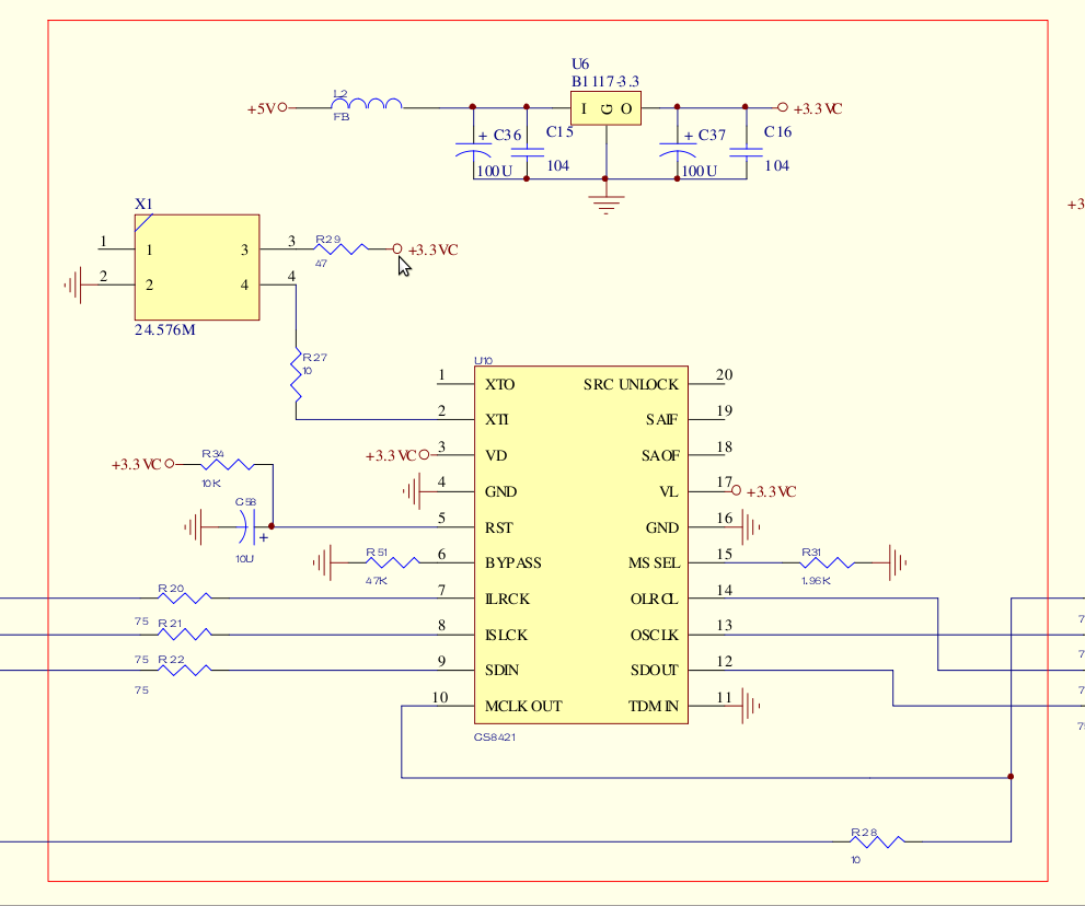

So when a 192Khz stream is passed to the the upsampler it gets into troubles, ans I wonder why? I thought that the upsampler should have operated as bypass when a 192Khz stream was played, but instead something wrong is happening.
Having just started playing with the CS8421 myself, perhaps I can help. Look at page 22 of the datasheet, para 4.3.7 - here it explains how fast a master clock is needed for various input/output sample rates. I am assuming your board is working in master mode on the output, slave on the input.
I have no clear idea what the schematic is of the 8421 board that you're using but my best guess is its not using a fast enough master clock to work correctly at 192kHz incoming rate. The equations they give there mean the master clock must be at least 24.96MHz to work correctly - if they are using 24.576MHz (a very common choice, its 512 * 48k) then 192kHz incoming won't work.
Your solution is simple - fit a 25MHz oscillator - of course the output will be running slightly faster than 192kHz but that's normally not a problem.

I think I understood the problem, even though I don't have an electronic backgorund (I am a poor mathematician). I guess abraxalito is right.
Tracing the upsampling board I could check that it is consistent with the schematic (see attached png file where I report only the upsampling part). So the MS_SEL pin is connected to a 1.96KOhm and this to ground, which according to the datasheet it means that Input is Slave and Output is master.
Now the quartz on my board is XTI=24.576MHz. Going back to the datasheet in section "6.1 Clocking" it says
"If the output is set to master, Fso<= XTI/128 and Fsi<=XTI/130."
Then if I am feeding a 192KHz=0.192MHz I have
Fso=0.192MHz while XTI/128=0.1934063
Fsi=0.192Mhz while XTI/130=0.1904308
so it seems that the problem is that my quartz doesn't accomplish the second condition. To get the second conditions I need XTI=130*192KHz = 24.96MHz.
Now since I am not an expert I wonder why these guys did the board this way.
Cheers
Pietro
I though the quartz should have a frequency which is a multiple of the output frequency, 25MHz/192Khz=130.208333. Is ti safe to mount a 48MHz crystal? I have two of them that I can rip from an unused radio board that could fit.
Cheers
Pietro
No. The master clock of the CS8421 tops out at 27MHz.
What would the result be if I mounted a 27Mhz instead?No. The master clock of the CS8421 tops out at 27MHz.
It would work fine I think - it depends on your output DAC's ability to be overclocked. I have a CS8421 driving into an AD1955, with a 27MHz master clock, this DAC is quite heavily overclocked (datasheet maximum is 20MHz) but still works and sounds great.
