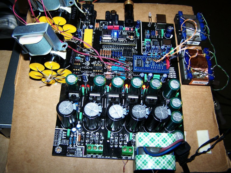

Trans I/V hum
My transformer I/V with PCM1798 is running good at 42R per leg into Edcor MXL8CS which are 1:8 so the voltage level isn't bad. Maybe about 6-8db less than the cap direct out of one leg of the CS43122 which is plenty loud direct into my amp with digital volume control wide open. I could use another 6db from the I out chip so changing to the 1794a should get me there even with the low resistance. The 43122 is really very good. Very detailed. The 1798 is also very detailed and may have a more natural sound. The sound is promising but I have a low hum I can't get rid of. Any ideas? Disregard the cap and transformer options that are visible at the left of the board in the photo. The PCM1798 module no longer has any signal connection out of the riser pins after removing the original signal resistors, caps and opamps. I originally had "A" ground on the input center tap and on the - leg of the single ended outputs. Then I tried floating the ground on the outputs but the hum remains. The 43122 has zero hum (just a slight hiss that I will need to work on) on the same board.

hi,
Do you have a scope?Or a laptop,you can download a scope program and use the sound input with a probe to test your signal,I would shorten as many wires as possible and use the scope to determine the freq. of the hum and start looking,check PS first and maybe move the transformers away from the board,or shield them in a metal can grounded to the CT,If ps is smooth,then start at input and trace it through till you find it ,you can connect a wire to ground and "make "ground checks as you go ,something will change the sound and you will know you're in the area of the problem,
try it and see what happens,Good hunting!!! alot of good grounding techniques on this forum....

buzz
I moved the the ps transformer around and it is radiating a little. That is just something I had laying around. I will have to get a better one. That is not the cause of the buzz though. The noise increases when I touch any of the grounds such as the top of the filter caps or the transformer shields. But not when I touch the RCAs for the trannie outputs which are now floating. It doesn't hum at all with the CS43122 in action and the output going out the other side through the caps or 1:1 transformers.

Download the 8421 datasheet and study it. Internally it does some complicated things that are beyond my knowledge base. It does mention problems with truncation distortion when the input format is not correctly set to match hi rez inputs, and it does not go into bypass mode automatically.
No tap
Still searching for the hum in the trans I/V of the 1798. I removed ground from the primary center tap. The hum remains but the conversion is still intact. A center tapped trans will only be necessary if you implement the load on the secondary side such as Rakk which opens up more options for trannies. I then connected ground back onto the minus leg of the single ended secondary and the hum went away. For one power on cycle. I think? I swear it was gone. Then it was back. Oh well. Listening over the hum, The CS43122 with a simple one leg cap out is better anyway. Maybe a mono mode PCM1794a with a class A I/V would beat it but that is a lot more complicated for multiple channels of an active cross.
