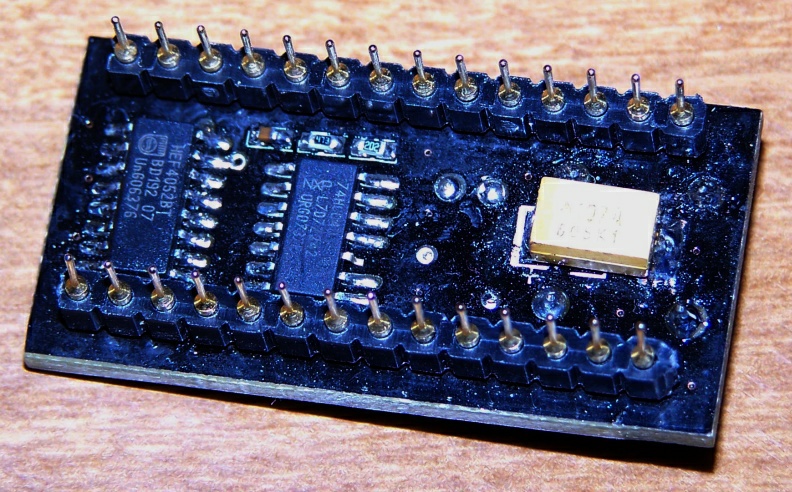

Coax is connected to switch
Coax is connected as well even though the schematic doesn't show any of this. To leg 14 of the switch but it doesn't work. I will have to disable the optical and swap pins.
Aha! You found it. The problem is it switches between opt and USB. You will have to convert one of those to coax if that's what you want, or add an external mux.
It's not an opamp, it's an inverter/buffer.
DIR9001 photo
I have verified that riser pin 4 from the coax is connected to leg 14 of the switch and both riser pins 10 and 11 for SA and SB are set to ground as they should be but the receiver will only lock to the optical. My SRC2496 and DEQ2496 have optical outs so I can supply an optical for now until I figure out how to fix it or just start using a hard wire instead of the switch. The item on the left is the switch. The other IC is the buffer.

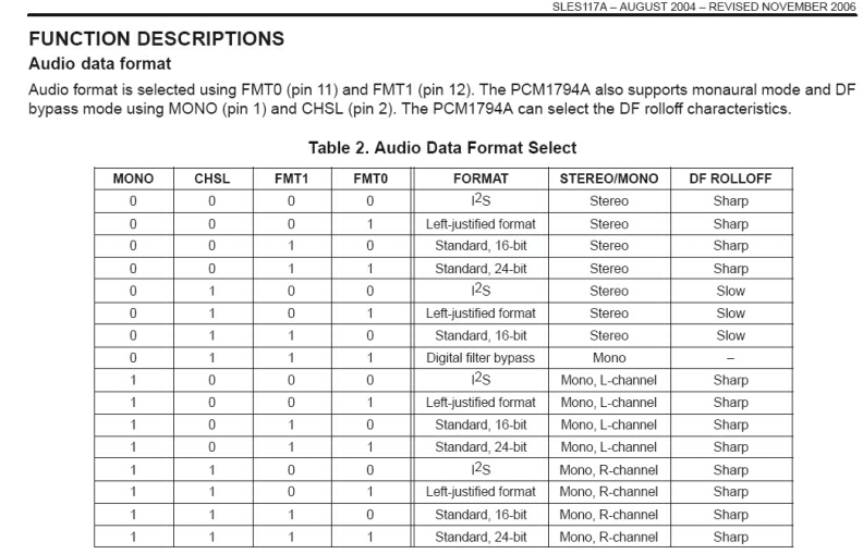

PCM1794a mono
Would running a pair of PCM1794a in mono mode double the available current output? If so this might bring the required transformer gain down to where you might get by with 1:2 depending on how much level your amp really needs to achieve a high listening level opening up more options for affordable transformers.
I don't think it works like that. Using PCM1794 in dual mono doesn't double the output, it just uses one chip for each channel. Each channel still has the 7.8mA output current that the 1794 provides.
mono
The chips are usually used with L+, L-, R+, and R-. By selecting a mono mode, which is one of settings available in the registers, you can get L+, L-, L+, and L-. You may need to add a small, well matched series resistor, like 2 ohms or smaller (maybe none), to each output to keep one or the other from power hogging, but the signal will be well correlated in the audio band so you should be able to parallel each pair for 15.6ma which should get the transformer requirement down to 1:2. The SPDIF can simply be shared (re-terminate to get 75 ohms if you like) between two boards with one chip set to left and the other set to right channel.I don't think it works like that. Using PCM1794 in dual mono doesn't double the output, it just uses one chip for each channel. Each channel still has the 7.8mA output current that the 1794 provides.

We should just be able to work with two stock Gigaworks boards to start. Either the big dac boards, or the the newer small dac boards if you don't want a DIR9001 or upsampler option. Just split the coax spdif with a "Y" cable as I have done with two DCXs without consequence and do the mods to set the registers to mono and create the parallel, transformer I/V mod. This should also work with the PCM1798 to get the output up and suitable for the 1:4 Lundahls that Rakk dac uses with a stereo 1794.this would be very interesting.

Stacked Mono mode PCM1794a
It might even be pretty easy to mod the stock PCM1798 module boards to stack one on top of the other in order to try mono mode with a passive I/V. Soldering another set of sockets onto the top of one board would be a piece of cake.I take it you would need to custom design a PCB to mount the two chips (vero board?) If you can work this out, definitely share the layout.
Rich
Next thought stacked
Then my next thought is. Do we need to select mono mode at all or would stacking two stock 1798 (or 1794) boards double the current output with no other mods?It might even be pretty easy to mod the stock PCM1798 module boards to stack one on top of the other in order to try mono mode with a passive I/V. Soldering another set of sockets onto the top of one board would be a piece of cake.
