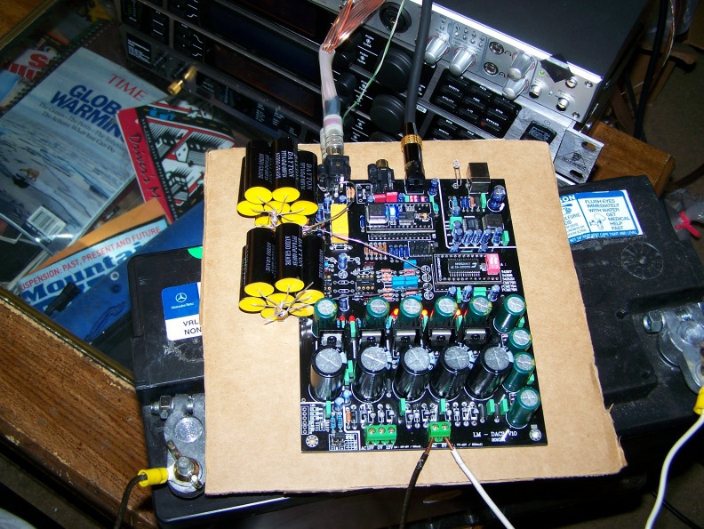

How about my impromtu battery power and cap coupled direct out mod. I know the transformer guys are twisting at their terminals seeing this but I did a comparison of caps vs Jensen JT-11-FMCF with my AK4395 dac yesterday and I still like the caps better. I will let you know what I think about the trannies on the CS43122 when I get the settings sorted out.

Caps vs trafos, different strokes for different folks. I like the organic, fluid nature of the trafos. A big part of it probably depends on the rest of your system. I use Pass clone SE amps, but the preamp and all interconnects are balanced.

I preferred an R-core transformer to the toroidal.
