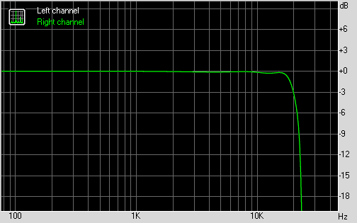

Another test. This time I'm driving an Antek AT-1008 with the primaries strapped to the outputs of a Sony str-dg500 100w amplifier and a 2000ohm resistor. The source is a emu 1212m and recording with the emu 1212m too.
I've included a baseline of the 1212m by itself. I'm guessing the rolloff is the Akm chip's built in 20k filter. I've bypassed all the output stage capacitors so it should hit 20k pretty flat.
I've tried reversing the polarity of the primarys. Makes no difference. This doesn't look to shabby? I'll have to unmount the AT-0358's and try the same test.
Valid test or was this just a kooky experiment?
P.s. I had to drop the protection circuit for this test. I could only squeeze .5w out the secondaries.

Your results look so similar to your test circuit limitations, I am not sure you are testing anything beyond that circuit.Another test. This time I'm driving an Antek AT-1008 with the primaries strapped to the outputs of a Sony str-dg500 100w amplifier and a 2000ohm resistor. The source is a emu 1212m and recording with the emu 1212m too.

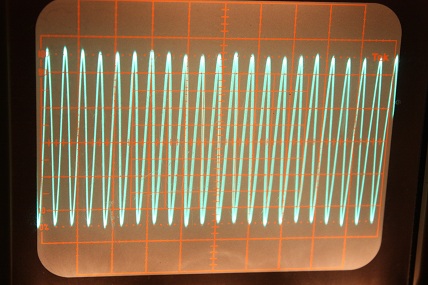

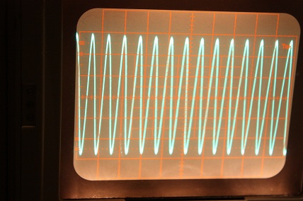

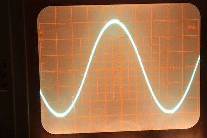

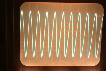

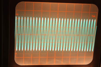

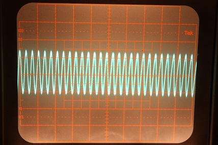

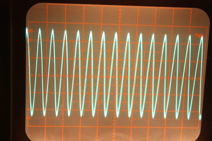

More measurements. This time I'm using an ocilloscope for measurements.
Other test information. The output resistance of the Sony is about 65ohms. For all tests I have a resistor that roughly matches the primary load resistance ratings as appropriate for the transformer. The secondary load is a 8 ohm resistor. Output is 0.5w or less.
The ocillioscope sensitivity is set to 5mv.
I tested the 1212m soundcard and it's output is flat as a board all the way from 20hz to 20k. The sony has a slight drop at higher frequencies so keep that in mind.
Measurements are at 1k, 7k, 10k, 15k, and 20k.
I barely have a clue about what I'm doing too.
First the at-0358.
First the at-0358.

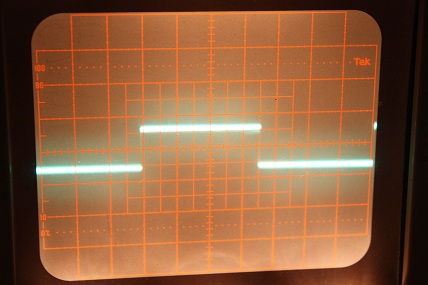

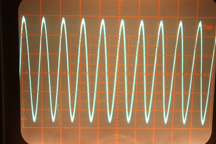

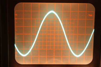

Now the at-1008. Same deal, but I've also included a reference 1k at 0.4v square wave.
