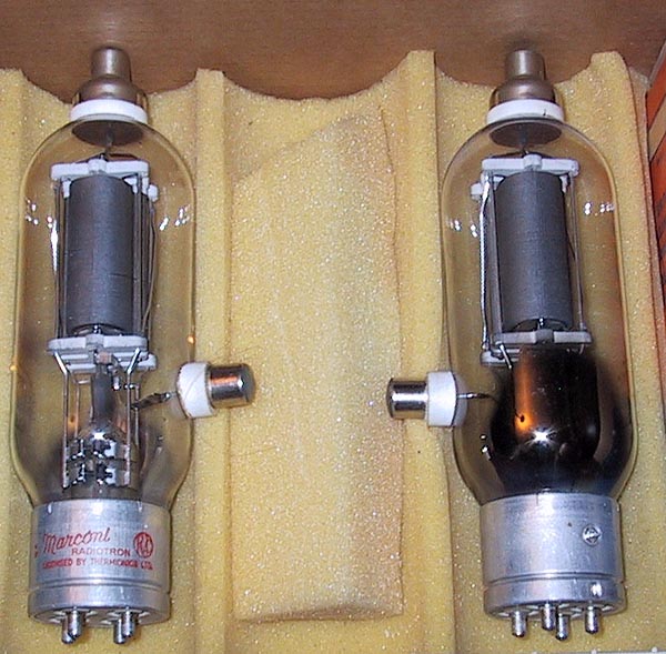

One of these days i'd like to do an amp with these 810s :)
Just cause they look so cool... they make an 845 look like a pip-squeak

True, but once you've held an 831 in your hands, even the 810 seems like a baby!
It's in the TT-3 manual... over 17" long with a plate rating of 400 watts. It can scare small children before you light it up.

Josh Stippich's GM100 amps at VSAC2003 were pretty damn scary too (and you could smell the ozone down the hall)
