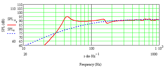

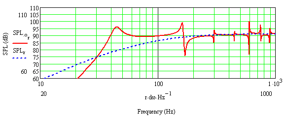

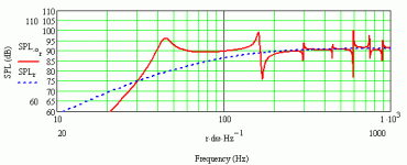

I'm assuming from that drawing that the panels are 18mm, with the front baffle doubled? It's certainly more akin to an MLTL than a BR. In fact, given the slight taper, it's technically an ML TQWT.
If my dimension assumptions are correct, then This is the anechoic FR of that cabinet, without any damping, using the D9nf, which is pretty much what I expected.

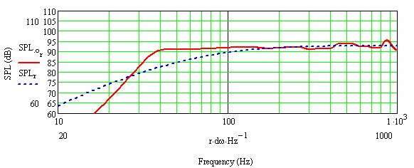

Adding 0.35 lbs ft^3 of damping to the top 23in of the line does this:
Frankly, it's not a balance I would recommend. Especially when room-gain is factored in, things can very easily go pear-shaped with this sort of alignment, even with very careful amplifier-matching & positioning. Like a lot of people, I find speakers with a peak at cut-off entertaining in the short term, but rather tiring to listen to over an extended period.
Suggestion: a) make sure the box is either lined, or has some stuffing added. As-is, it's underdamped. And b) staple a thin layer of felt over the inside of the port & adjust the thickness to taste. You'll get a smoother response & it will take down that peak at Fp. Immediate reaction will probably be something in the nature of 'it doesn't sound as "free" ' or similar, but it'll be a whole lot more balanced & easy to listen to in the long term.

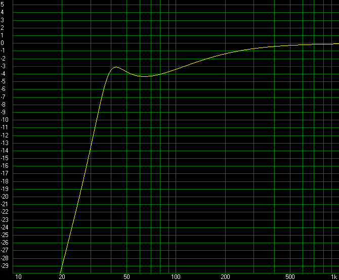

Like a BIB the sim looks like it is screaming out for a helpful room factor ... but with little to load it probably won't get it.
On the face of it, this box gives one to think that the speaker is excelling because it is just that good, and in spite of an unhelpful enclosure. The one thing going for it is that any walls are fairly far off from the driver, reducing reflection. It would be interesting -- and a good source for some valuable data -- to see what would happen if one made the port aperiodic.
