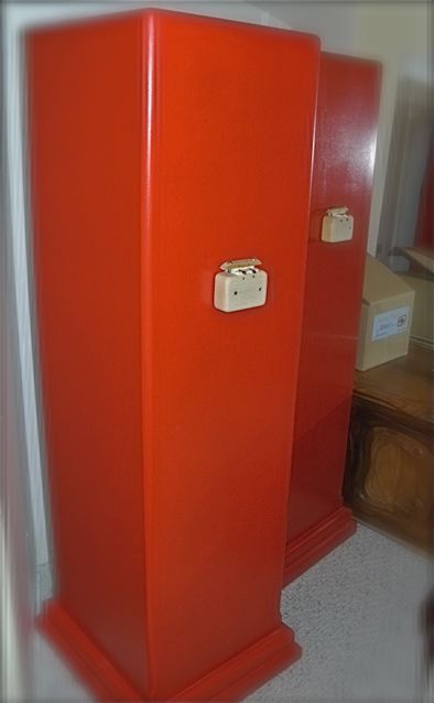

Stuffing the Feastrex Box
Yesterday I removed the back of the Freddy Box and stuffed it.
I measured out 31 grams of silk for each box. Thats about an ounce of sil. My wife had some arts and crafts paper glue so I used that to stick the silk to the inside.
The silk is stuck to the back of the box.
Screwed the back back on and fired it up.
It seems to have worked just fine. The box is better...so far it will take some time for me to see if the 31 grams is to much or to little.
At first blush I would say it may be to much...maybe 15 grams would be better.
Time will tell but its a start.
I like the way it sounds with the stuffing. The female voices seem less edgy.
I didn't notice a loss of bass and maybe the bass is better as a result. Not more bass but cleaner and clearer.

Ideally, the box wants lining to kill any standing waves. Top, one side-wall, & back, making sure the throat is clear will be ~ideal. Stuffing is a viable alternative -I doubt the difference between the two would be audible. My fault -I didn't really mention this before because I made the assumption that everyone would automatically apply standard BR cabinet construction details like that (& add any bracing etc that they wished) as a matter of course.
That's typically a good starting point. What you want is to supress any possible standing waves with the minimum possible damping materials (of course you can add more to suit your individual requirements). Lining opposite faces with a light layer of your favourite material sorts that out, especially if you've used golden / some other acoustic ratio (like the old H = 1.414 x W & W = 1.414 x D), or close to it, which ensures for all practical purposes a ~uniform air particle density within the cabinet & minimises potential standing waves.
