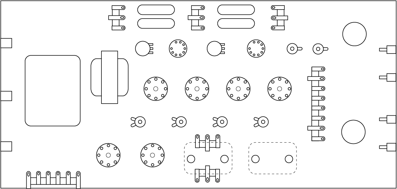

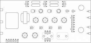

Here's a diagram to assist you in tracing out the circuit. Just connect the wires. Either print it out and draw the wires, or draw the wires in some pic editor on the computer. Your choice.
Draw in the Octal keys so we know where pin 1 is, I can't see them in the photo.
..Todd

I think you were right with CLC, Ian444. It looks like there is a choke in the photos.
Yes, you're right there. On second take, it looks like the first 2 green resistors are screen grid resistors.
Oh, I thought you measured one cathode resistor to be 244 ohms and the other to be 199 ohms?
Yes, the left channel pair reads 244 ohms and the right channel pair reads 199 ohms. Each pair in each channel shares one resistor.

WOW! Thanks Todd!
Depending on how I feel tonight when I get home (around 9pm), I may start working on this diagram. Been working some long days lately so it's been a bit rough and I'm usually exhausted when I get home, but we'll see.
Thanks again Todd, I really appreciate it!
Just got home a little while ago and decided I'm not going to attempt to do this diagram until the weekend when I get home a couple hours sooner.

That schematic on ratbagp's blog explains a thing or two. The amp was originally built assuming different output tubes for each channel. Replacing the output transformer and tubes got you most of the way to a 'stereo' amp, but the cathode resistors are different enough still to make your output tubes run with a different bias current, and probably a bit different grid bias voltage in operation. Swapping out that 200 Ohm cathode resistor to 250 ohm to match the other channel will make them operate identically.
Not sure if the difference is really worth the hassle though. I'll defer to the veterans on that issue.
